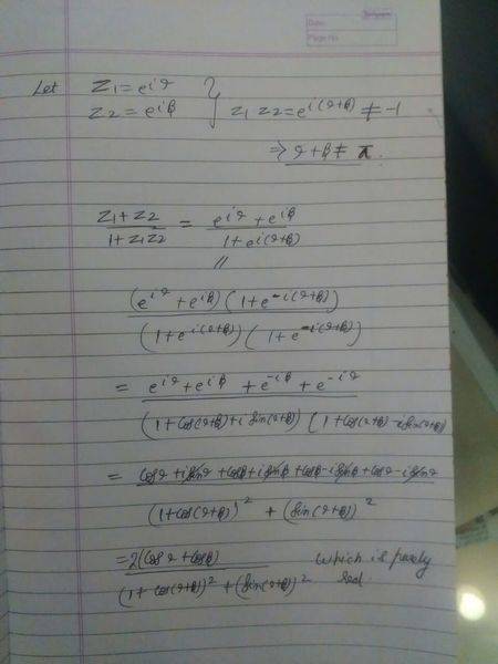

z1, z2 are complex numbers.
If z1z2 =/= -1
and |z1| = |z2| = 1
then number :
z1 + z2
________
1 + z1z2
is real.
z1 = (a+bi), z2 = (c+di)[/B]
Should i use this extended form or is there a shorter path ? because it's pretty long.

You loose a few brownie points, but what the heck: what is the locus of points ##z_1## and ##z_2## in the complex plane ?
Locus? maybe there is a different name for it, I'm studying linear algebra 1. hmm vectors you mean? or circle unit?
Unit circle is the name. And yes, locus is the collection of positions ##z_i## can occupy in the complex plane.
One way to pinpoint a complex number is by Re() and Im(), real and imaginary parts (your ##a## and ##b## ).
Another way is with Abs() and Arg(), absolute value and angle . Since in this exercise ##Abs(z_i) = 1## that's what you want to adopt !

Can write z1 = 1(cosx+isinx), and z2 = 1(cosy+isiny), where r = 1?
and then plug it in the fraction?
You can indeed. A short form for ##\cos\phi + i\sin\phi## is also available (saves writing effort :smile:).
cosx + isinx + cosy + isiny over 1 +cos(x+y) + isin(x+y) +1
Hehe, you reluctant to write $$
e^{i\phi_1} + e^{i\phi_2}\over 1+e^{i\left ( \phi_1 +\phi_2\right )} $$ or something ?
Now: what's the road ahead if you want to show this fraction is a real number ?

can i take conjugate of all the fraction?
on the bottom i'd get though sin(-x-y)i =/= sin(x+y)i
BvU said:
Rapid fire postings ! We are at $$\cos\phi_1 +i\sin\phi_1 \ + \ \cos\phi_2 +i\sin\phi_2 \over 1 + \cos\left( \phi_1 + \phi_2 \right ) +i\sin\left( \phi_1 + \phi_2 \right ) $$ and we want to work the denominator around to something that is a real number (so we can forget it). Agreed ?
agreed
Not all the fraction ! Then you get something that is definitely real and non-negative, but is not equal to the fraction and has no information on the imaginary part of the fraction any more.
No, you multiply with 1 :smile: . Namely complex conjugate of denominator divided by complex conjugate of denominator !
And there would be a ##\ -i\sin\left( \phi_1 + \phi_2 \right )## in there indeed.
Note that you don't have to work ut the denominator any further: you know it's real, so that you can concentrate on the numerator.

Ok i didn't get any of what you just said hehe. If i take the whole fraction conjugate, tries to make equality between them(conjugate and non conjugate), then it's real number, i mean if there is equality , no ?
z* = z <==> z = real
I see what you mean. But I expect you'll have a hard time to show that ##z^* = z##...
My proposal was to take the fraction, multiply with 1 in such a way that the denominator becomes a real number and then try to show that the numerator is a real number as well:$$ {\alpha\over \beta} = {\beta^*\alpha \over \beta^*\beta}$$ is real if ## {\beta^*\alpha} ## is real. (##\ \ ^*## means complex conjugate!)
As for my suggestion, you need only to show that -six-siny = sinx + siny, and sin(x+y) = sin(-x-y)
As for your suggestion, you mean should i multiply Numerator and Denominator by 1+cos(x+y) - sin(x+y)i ? wouldn't it become mess in the numerator?

He, how did you so quickly agree to $$
\left (\cos\phi_1 +i\sin\phi_1 \right ) \left ( \cos\phi_2 +i\sin\phi_2 \right ) = \cos\left( \phi_1 + \phi_2 \right ) +i\sin\left( \phi_1 + \phi_2 \right ) \ \ \rm ?$$
That's going to be difficult, I guess :smile:?
That's why I preferred the ##e^{i\phi}## notation -- it gave me a pretty quick result. Now it's a bit more involved (and I didn't write it out in full yet o0) )
the imaginary part : sinx + siny + cosxsin(x+y) -cosysin(x+y) + sinxcos(x+y) +sinycos(x+y) = sin (2(x+y)) -sin(0?) + sinx + siny.
sinx + siny should be add to 1 right ? since the length is 1. how is that looks?
seem like it might go to zero
