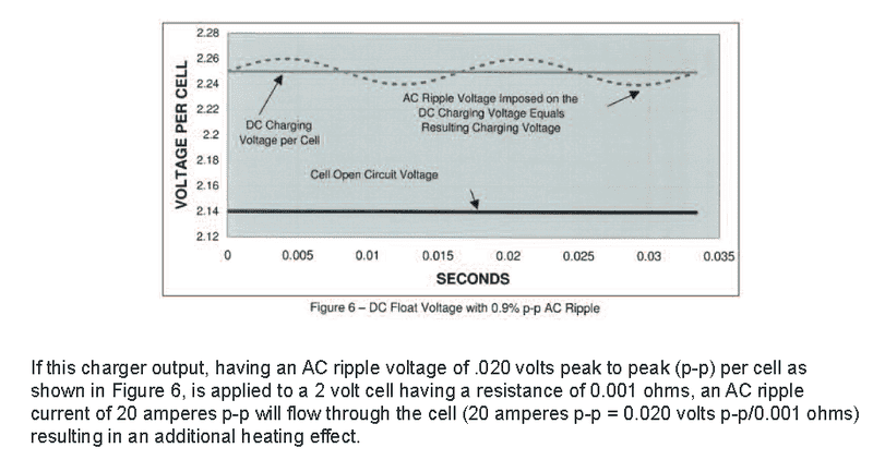

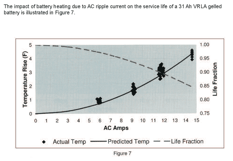

Might also be a ripple current issue. I don't know if it is, but good troubleshooting rules out the possibilities one at a time.
Industry papers on effect of ripple on batteries confirm it heats the electrolyte and to an extent the plates too. It shortens battery life.
The heating is easily measured. Do your batteries get warmer when running that inverter from them?
http://www.cdtechno.com/pdf/ref/41_2131_0212.pdf
http://www.battcon.com/PapersScanned1999/GernerPaper1999.pdf
http://www.ecmweb.com/ops-amp-maintenance/get-know-your-battery
Ripple current — Excessive ripple will cause internal heating of batteries. Ideally, ripple current should be less than 5A for every 100Ah. However, ripple current says more about the state of the charger than the battery. Ripple current does not provide any information about SOC, capacity, or SOH.
You ought to look at your inverter's current draw with your oscilloscope if only to rule put the ripple issue .

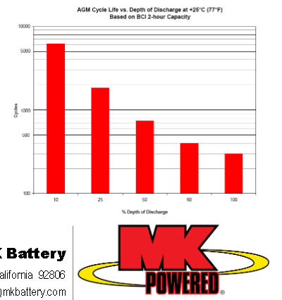

BernieM said:
They are 8A8D with about 265Ah storage each. The brands are Deka and Interstate
East penn's site is hard to navigate . I don't know what the LTP means.
http://www.mkbattery.com/images/8A8DLTP-DEKA.pdf
Here's the life vs discharge depth curve from lower right
at 50% discharge maybe 700 cycles ?
C/20 = 245 AH / 20 hours = 12.25 amps, X 10 sets = 122.5 amps, X 24 volts = 2940 watts at 20 hour rate.
So you're not overworking it a lot at 8kw.
At 5KW, 21 amps per battery pair, i get a little less than 6 hours to 50% discharge? Does that agree with your calcs?

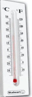

Everybody stresses temperature and you have a lot of it out there. Try taping your temperature sensor right to a battery case ?

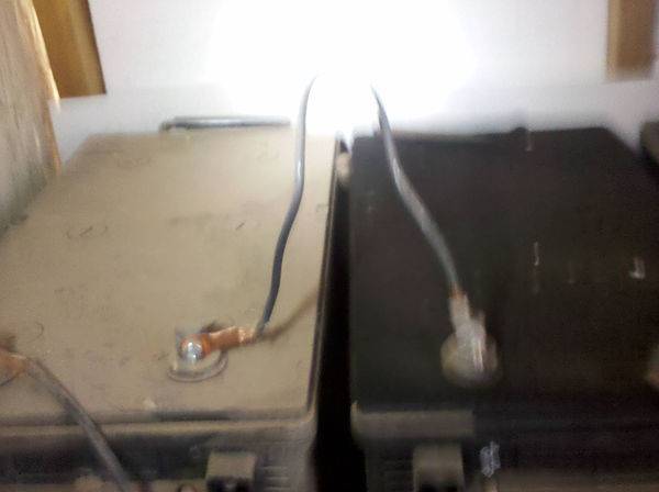

Since day 1, ALL battery failures have been the battery (of a pair) connect to the + of the system. Never the battery that's connected to the -. Now as I recall, heat moves in the direction of current flow from positive to negative. One of the principles of of a peltier diode. It is true it gets very hot here, and where the batteries are currently in this system, they see a fair amount of heat, (yet never as high as outside temps. To cure this heat problem I almost have finished an underground battery cellar 9 feet deep.) So if it is a heat issue, then the + terminal would be the hottest in addition to temperatures externally (which max out at around 98F.) Current would be related to post/wire heating as well, which then may be a cause for this strange phenomenon.
The other locations where the batteries are stored are similar to mine. In shaded locations where it does not get as hot as outside but not as cool as inside. The other 24v system is in a garage attached to the house, mine is on the front covered and enclosed, insulated porch.)

Since we are about down to brain-storming for a solution, check the temperature of the connections to the battery posts during a high current situation. Gross problems would be detectable with your finger.

It looks like you have the wrong battery chemistry for your usage.
Also, is the charge controller in the same thermal environment as the batteries? That way it can adjust charge voltage to track the battery temperature.

I have 3 meters. One is built into the controller. One is built into the remote battery monitor I have attached, and I have a hand meter. All of them agree within a reasonable row of corn as to the voltage. There is no meter that's mysteriously reading low.
I will see if I can get the time to move the scope out there and check it for a/c ripple superimposed on the dc.
Regarding post temps: I just went out and checked, and though my optical thermometer was recently borrowed and not yet returned, I put the contact of the outside temperature probe right on the positive post. Air temp is 95F and post temp is 91F. It's about 1pm and the reason the post is lower than air temp is that overnight it all cooled down and takes a long time to heat up all that mass again the next day. But I have never found posts to be hot. By the way, the charge controllers advise connection of the temperature probe that comes with them to be attached to the + post. Which it is.
Load is about 2.5-3kw right now, as I am running 2 a/c's, a tv, a desktop pc with a 500w power supply in it, a chest freezer and a refrigerator and some lights. And that's about as much load as I typically run. Though there may be occasion where I run a heavy load like table saw, it's rare and usually isn't for very long.
No, it is not 4 failures. It is 4 failures in the last year with this array of batteries which have been in a year and a half, or thereabouts. Prior to that I had some smaller batteries which I had the same problem with, and had two of those go bad in about 1 year. And my friend's installation is now in place about 1 year and has had 1 failure. ALL OF THESE FAILED WHILE BEING THE BATTEY CONNECTED TO + IN THE PARALLEL BATTERY ARRAY ... and that's why I came here to see if there was something I was missing on what could cause battery failures like that. So far I have not found anything, even the a/c ripple to explain it. Why? Because that ripple would be spread out over 10 pairs of batteries. I think that would be a very noticeable thing.

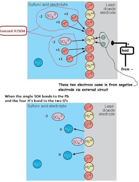

One cell of a battery: (Did i get all seventeen plates?)
i said it was esoteric...
Test of 'heat following electron flow' hypothesis:
In failed car batteries-
is it always the cell adjacent positive post that fails?Good Luck,old jim

Here's a snippet from a sort of relevant article on the phenomenon
of course it's speaking to charger ripple not load induced ripple
article is at http://www.cdtechno.com/pdf/ref/41_2131_0212.pdf
another article that's long on pictures and short on words is here
https://www.victronenergy.com/live/_media/ve.bus:4._ripple_in_a_ac_battery_system.pdf
Between the two i think it's comprehensible

OK I noticed yesterday that there are two pairs of batteries exhibiting an odd difference. Here is a picture of one, the other isn't quite as bad as this yet. Both batteries are dusty, and neither has been cleaned. The one on the right which is coincidentally connected to the positive lead that connects in parallel with the rest of the array, is dampish. There has not been large amounts of acid or water coming out of the battery, because there is nothing dripping down the side, it's only on the plane of the top. I disconnected the batteries from each other and measured the voltage. They are both fully charged. The voltages are exactly the same. However, I think this is an early stage prior to failure in the manner that I have been talking about. That left uncorrected (whatever the problem is) that in the near future this battery will fail.
I checked the water level on it and it is not significantly different, if any really. So not much acid or water has come out of the battery. I am betting it is water vapor that has vented out across the battery while equalizing.
I have been doing a lot of research lately, and I have found some references to differences in charge rate of batteries in series, caused by internal temperatures. The positive connected battery may be heating up just a bit more than the second one, due to the effect of heat flowing from positive to negative as mentioned in the peltier effect. So heat generated by current will start at the positive and migrate toward the negative post. This small difference in temperature when temps are in the 90F temperature range, makes a large enough difference between the two batteries that while charging one will charge a little less than the other, amplifying any small difference to begin with. Over time the difference is cumulative, and eventually gets into a condition possibly of runaway. The a/c ripple may be another factor involved as to why one battery is heating possibly more than the other. However since I haven't seen any high frequency, I'm not totally sold on that yet. Will be checking into that further in the coming days.
Here is a post that describes the same issue I have experienced:
http://www.continuouswave.com/ubb/Forum6/HTML/003774.html
So, I think the bottom line is that there is nothing perfect, so the cells all have minor differences in impedance. This minor difference becomes amplified with time as the battery is cycled. At one point it becomes large enough to become a problem and cause the failure, and that heat is the major factor, whatever it's source.

Conduction across the top of a battery , through acid slime between its terminals, is a load on that battery just as surely as a would be light bulb. It'd steal charge from that battery and not its series partner. One would expect though to see bubbling if it got as high as an amp ?
Try your dmm on current scale, one test lead to a post and other into that dusty stuff . Wave it around to see if there's conductive spots. That's ruling out long shots, part of troubleshooter's last stand.

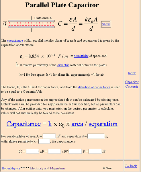

But I can build one,
(Big Capacitor)
I would be interested to know how well you manage to do that. I guess if volume is not a problem, you could hope to do what the manufacturers manage to do in reasonable sized packages. It's quite a problem to roll two foil strips and two dielectric films with many tens of turns and to get them even and undamaged. Why not just buy Capacitors, anyway? The film and the foil are pretty expensive to get hold of, in any case.
Try your dmm on current scale, one test lead to a post and other into that dusty stuff . Wave it around to see if there's conductive spots. That's ruling out long shots, part of troubleshooter's last stand.we never resolved why your 'scope reports different than your DMM. Some DMM's won't read small AC in presence of substantial DC , that's why i suggest try a small capacitor in series with test lead.
Keep after it...
No current flow either to negative or positive post in the wet dust.
Checked DMM again. Still the same result. I'm betting the current is too small for the meter to detect the frequency. When I check a/c current, it shows zero.
So it can be seen on the scope but not a meter. I also tried my clamp on ammeter but it showed no a/c as well.
I'll disconnect the + lead and put the meter in line to check a/c amps and see if it reads that way. That's in my mind the best way to check it anyhow. It will show current flow regeardless of freq if there's a/c on the line, as long as it's significant enough. Though I don't know what the frequency response will be on the meter in the a/c current mode, but I bet it's higher than 3000hz. And the current can be tested into the μa with the meter I have.

A flat capacitor is easy to make. Just make two bar clamps made of copper or aluminum and layers of aluminum foil or sheet between the two clamps, alternating which clamp they are clamped by, each sheet coming just short of touching the contact/clamp on the opposite side. Place a sheet of thin insulating material between each conductive layer. For more capacitance add more layers. Attach wires to the two clamps. Instant non-polarized cap. Pretty simple really.
That was a Telephone Exchange. This is a shack in the desert with batteries on a screen enclosed porch. Lots of dust. I don't use grease I use a battery spray that is conductive and inhibits corrosion. If you have OCD and dusty batteries bother you, you are welcome to come here and clean these daily! I hope you can handle 110F+ temps though!
