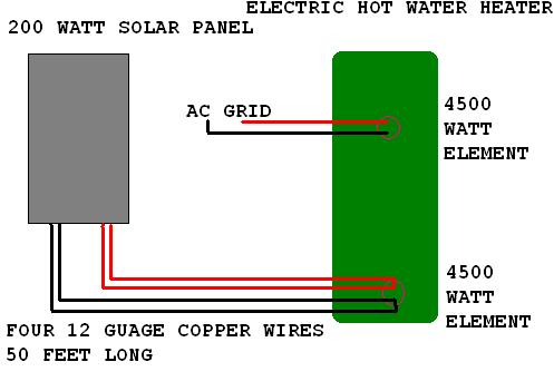

If one hooks up solar panel to bottom element after removing AC line seemed like good idea then I was wondering if the wires going to the element will get hot instead of the element see drawing.

If that solar panel really has just 200W maximal power you don't have to worry, it won't make anything hot in that setup.
Especially your 4.5kW heating element...o0)
... but I would advise against trying this with a matching 4.5kW solar panel array. DC voltage at that power is not a joke. :warning:

Hooking a "200W" PV panel to a "4500W" heater element in a water heater is a total mismatch in impedance, and you will be wasting lots of power. Do you understand what the "200W" rating of that PV panel means? Do you understand what that "4500W" heater element rating means? (What voltages and currents apply to each, for example?). Have you learned about Maximum Power Point Tracking (MPPT) for PV panels yet?
According to my calculations, a 24 volt, 200 watt panel, @ 4 hours solar input per day would supply about 10% of the energy required for a 100°F/38°C, 10 minute long, 2 gpm(7.5 lpm) shower. (60°F[16°C] cold water supply temperature)
But if a DC-DC step up device were installed, to up the voltage, such that the panel could supply its full potential of 200 watts, that would jump to 40%.
Not too shabby!
At 24 volts, the panel is limited to 50 watts, with the heating element's 11Ω resistance.
Actually, a 48 volt, 200 watt panel would supply 200 watts without an inverter, in this case.
Yay! No fancy circuits to burn up.

John1397 said:
... I was wondering if the wires going to the element will get hot instead of the element see drawing.
For a 48 volt panel, I get about 4 amps for your system.
I believe 12 gauge wire will handle that.
So, no. The wires should not get hot.
(Compared to the element that is. Anything with resistance is going to have an associated temperature rise when you run a current through it. So if you are cleaver enough, you might be able to thermally insulate your wires, and start a fire.)
200 watt panel actually only puts out 100 watt against 4500 watt will not be much but I will get 1KWH per day should take chill out of water is what I am thinking. Battery has different characteristics than fixed load do not know if MPPT would do much good.
I'm an engineer at heart (as well as at work), and the idea of throwing away over half of the available energy (probably more in your case) is unpleasant for me.

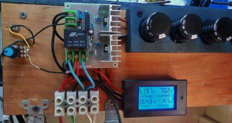

I build these MPPT systems to make hot water and they are quite simple to build, but far too complicated for most people. The fundamental principle can be found in this paper https://www.mdpi.com/2071-1050/13/18/10270/htm As an example, my garage has a 40gallon hot water tank for laundry with two 4500W 240V heating elements in parallel at 60V DC from solar panels. This provides enough hot water to do all my laundry loads with hot water. Tall tanks are preferred because of stratification. The top third heats easily and the lower part provides pre heating. Less than $20 besides panels. Just a fixed voltage setpoint is sufficient if adjusted seasonally. I use mine in parallel with a MPPT charge controller to harvest excess solar which would otherwise be wasted.
