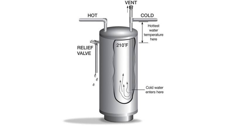

Why does hot water rise to the top of a water heater?
I am enrolled in a plumbing program with Stratford Career Institute. In the chapter in my plumbing textbook about Water Heaters, the textbook authors assert that hot water in a water heater rises to the top of a water heater. The authors assert that cold water sinks to the bottom of a water heater.
Here is an exact quote from the textbook:
"The design of the storage tank takes advantage of water's natural properties. Figure 18-2 describes how a water heater functions. The cold water supply pipe typically connects to the water heater at the top of the tank. A pipe on the inside of the tank directs the cold water to the bottom of the tank. As the water is heated, it expands. Since expansion makes it lighter, it rises to the top of the tank, where it can be drawn off. As heated water cools, it becomes denser and sinks to the bottom of the tank, where it is heated again. This circulation of water within the tank ensures that a reservoir of hot water will be available at all times."
Before I read this textbook, I never would have thought that if a given quantity of water was heated, that it would expand. I don't understand this. Does water expand when it is heated? Let's say that I have an empty 5-gallon size bucket. I pour exact one gallon of 50 degree fahrenheit water into this 5-gallon bucket. Then I put the 5-gallon bucket with one gallon of 50 degree fahrenheit water on a stove, and I heat the water in the 5-gallon bucket up to 100 degrees fahrenheit. Would the water in the bucket start occupying more than one gallon of space in the bucket when the water reached 100 degrees?

Water expands when it is heated.
That is the reason behind the pressure relief safety valve that you see at the upper section of each water heater.

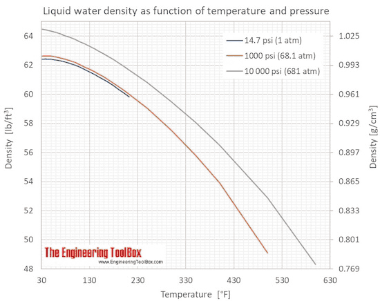

Let us see what Google can dig up about the density of water as a function of temperature...
Search phrase: density of water versus temperature
First hit: https://www.engineeringtoolbox.com/water-density-specific-weight-d_595.html
You care about the blue curve on the bottom that cuts off at 212 degrees Fahrenheit. The pressure in the water heater will be a bit higher. So maybe you care about a curve in the gap between the blue and yellow.

We can look up the bulk modulus for water. It is about 2.2 gigaPascals (GPa). That is about 22,000 atmospheres. You can think of that as how much pressure it would take to change the volume of some water by 100 percent. [More properly, it is 100 times the pressure it takes to change the volume by one percent]
If we look up the density of water at 50 degrees Fahrenheit, that's 0.99965 in grams per cc. At 100 degrees, it is .99308. That is a change of about 0.69 percent.
So we would need to apply ##22000 \times \frac{0.69}{100} \approx 150## atmospheres to prevent the water from expanding and keep it in the heater. This matches what I can read off the graph I'd posted up-thread. Without a pressure relief valve or some air space, your water heater may have problems.

I just looked at the picture in figure 18-2 in my plumbing textbook, and it does show an air gap at the top of the water heater. So I suppose that most water heaters do have an air gap at the top of them, which would allow the hot water to expand.

Per the 2nd link in the 2nd post:
When water is heated it expands. In a 40-gallon water heater, water being heated to the thermostat setting expands by approximately 1/2 gallon. The extra volume created by this expansion usually pushes back into the water tower of public water supplies, or into the well tank in homes with a private well, resulting in negligible pressure increase. However, on public or shared water supplies were a backflow device is installed on the water main feeding the house, the pressure can no longer push back into the tower or well tank. With no place for the expansion to go, pressure will dramatically increase.
So in my house, where there is no check valve or backflow device installed, the water is free to expand into the house pipes and public water supply and there is little to no pressure increase inside my water heater tank. If the water expanded into an air space I would expect to see a slight 'burst' of high pressure hot water whenever I first turn on the hot water in my sink or bathtub as the air expands and pushes on the water, but I do not see this so I guess the pressure in the tank is the same as in the supply pipes. Perhaps others have this issue if they have check valves or backflow devices, but I do not know.
Some water heaters have two heating elements, one at the top and one at the bottom. Some water heaters only have one heating element. If the water heater only has one heating element, the heating element is at the bottom of the water heater.
If a water heater only has a heating element at the bottom of the water heater, an air gap at the top of the water heater would be beneficial because it would allow the circulation of the water in the water heater as water is heated in the water heater. If the water heater only has a heating element at the bottom of the water heater, and if hot water rises to the top and cold water sinks to the bottom, the circulation of the water in the water heater would cause all the water in the water heater to get heated. If the water heater only has a heating element at the bottom of the water heater, and if the water did not circulate in the water heater, you might have hot water at the bottom of the water heater and relatively cold water at the top of the water heater instead of the entire tank being hot water.

What happens in water heater tank is convection.
Start with a tank, full of cold water. Put a heating coil near the bottom and the water around the coil will warm up and expand. It's density will be lower than the surrounding water; it will move upwards and the cooler water will fall towards the bottom. That's Convection and the water will carry on circulating and mixing until it's nearly all at nearly the same temperature.
You may have come across 'Immersion Heaters' that have a long heating element, which reaches right down to the bottom and also a short element that only reaches 1/3 of the way down. Convection doesn't work downwards so the short element only heats the top 1/3

Water shrinks to almost but not exactly 1000 g/l on melting:
1 l of water weighs 999,85 g at 0 C. And water shrinks further on warming - weighs 999,975 g at 4 C.

In any case, water above 4 C starts expanding. It is 999,1 g/l at 15 C, 997 g/l at 25 C, and 958,4 g/l at 100 C (all at 1 bar).
