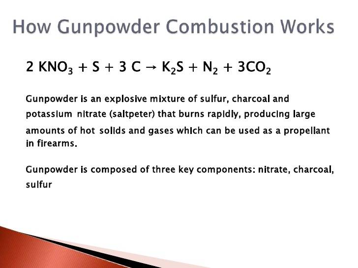

No, the nitrogen is sort of a carrier or binder:
The thought the OP never completed is that the thing that makes potassium nitrate more useful for solid rockets oxidizer is that it is...a solid.

You need to select a solid that will burn without leaving an ash.

It reduces the efficiency. To maximize thrust the resulting amount of gas should be maximized and the amount of liquids and solids minimized. It is possible to build rockets with propellants which produce ash (e.g. firework rockets powered with something like gun powder) but at a large scale it is not a good idea.
