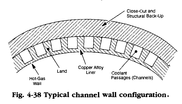

INCONEL is typically used for the outer liner of the nozzle, but why not titanium alloys?
Industry standard right now is a copper alloy (usually an aluminum bronze) inner liner to promote heat transfer to the coolant channels and the walls of the channels and outer liner are usually made of an INCONEL alloy, usually either 625 or 718.
But INCONEL is VERY expensive and heavy. The outer liner of the nozzle actually is not exposed to high temperatures, the inner liner however can commonly reach 700K+ especially without film cooling. But the outer liner is completely different, it is exposed to the fuel (my case being CH4 which is cryogenic) and depending on how the channels are designed, the max temperatures it should see (outside of ambient temp) are 140K to 190K. So INCONEL's high temperature performance is not needed. Instead it comes down to cryogenic performance.
Unfortunately I couldn't find much data on titanium alloys like TI-6AL-4V, the only information I found was this: https://apps.dtic.mil/sti/pdfs/ADA398407.pdf which concluded titanium is very bad for usage in liquid oxygen tanks, often resulting in an explosion. Since the outer nozzle liner isn't exposed to LOX (only the injector manifold, plate, and inner liner which are made of different materials), it would be safe.
Why titanium? My reasoning for wanting to use titanium is it's performance is comparable to INCONEL. It has good high temperature performance, high melting point, can be used for low temperatures, corrosion resistant (oxidizes at high temperatures), and most importantly a very high strength to mass ratio, which is key to developing the type of rocket I want. The two major concerns I have are: 1) insufficient data on cryogenic performance and cycle life 2) INCONEL can briefly withstand temperatures as high as 1400F, which the rocket this would be used on will have the booster re-enter without a retro burn, so brief elevated temperatures are expected.What do you guys think? Just use the industry standard (INCONEL) or does titanium alloys actually seem like a good alternative?

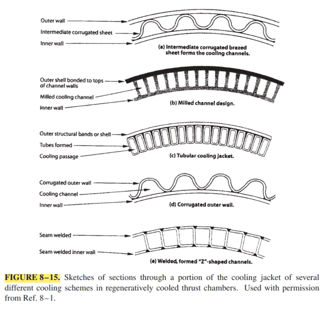

Thanks for the reply!
Above are the different methods for the cooling channels. The most common are the tubular jacket and milled channels. My design uses the milled channels but with 3D printing. But you can see the outer liner is only exposed to the coolant channels containing the cryogenic fuel. The Merlin 1D engine as an example, uses a copper alloy for the inner liner and the outer liner is a nickel alloy (Elon himself stated this).
Titanium I have not heard of be in short supply, Nickel I was warned is increasing in price from demand. Cost wise, titanium is much cheaper than INCONEL, as INCONEL is a nickel based super-alloy. The cost is a primary demand of why I would like to switch, but also the weight savings would be tremendous (current stimate has the nozzle at 55kg alone with INCONEL). I hope for the rocket this engine will be mounted on to be able to re-enter without a retro burn for protection, which a big aspect on whether it can or not is the dry mass/surface area exposed on re-entry (the engines will be facing towards Earth, otherwise it's going to want to flip around until it is in that position and will likely destroy itself). So by eliminating a large portion of the dry mass, I not only get a boost from a higher dry mass to propellant ratio, but the atmosphere will help slow it down so it can be recovered.

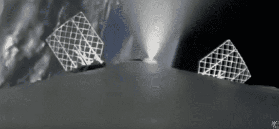

Thank you for the info in your last post- informative read to see how the cooling channels are in fact made of multiple materials.
Another puzzling thing to hear... Am I understanding you correctly that this craft will be re-entering with the bells absorbing the reentry? From what I've learned I'm not aware of systems that can withstand reentry like this without a blunt-body and a bow shock in front of it. Again, please educate me if I'm wrong here, but it seems like your system would just disintegrate.
Ozen said:
...the engines will be facing towards Earth...
That sounds super unstable at re-entry velocities.
A convex shield has a negative feedback loop when it comes to deviation (small deviations are self-correcting).
A concave shield will have a strong positive feedback loop (small deviations lead to larger deviations).

Yes you are correct, the engines are first taking the initial blunt of re entry. However they create a stagnation zone. It has been proven this method does work for recovery, Rocket Labs Electron booster has been successfully recovered multiple times now this way. They don't even use a landing burn but a parasail and a helicopter to catch it midair. They do have a heat shield on the bottom around the engines and they posted a picture of the returned engines, which had black "burn" marks on them. It is speculated they use INCONEL for their engines. The key to why they can do this is the dry mass/exposed surface area ratio makes it where it acts "fluffly", so it slows down much faster than you would expect.

It should be stable, the engine bells cause a stagnation in airflow around them. And the center of mass is ahead of the center of pressure (which for a cylinder is the center), which that dictates rocket stability. That's why older rockets used fins, to move the CoP behind the CoG. It would not be possible to re-enter with the top of the rocket first in this case, the mass being so rearward will cause it to flip while reentering and the forces it would experience would rip it apart before it can reorient itself.

The Falcon 9 first stages don't do a full re-entry, but they do descend engines pointing down. Falcon 9s also deploy grid fins that appear to dominate the stability.

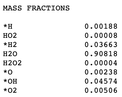

Manufacturing wise, it wouldn't be an issue. The plan is the nozzle would be made by 3D metal printing, which often are in a vacuum environment, the machines I'm eyeing even list Ti-6AL-4V as a suitable material.
You make a great point about the hydrogen embrittlement. That would indeed be a major concern, mostly for a landing burn where the exhaust can hit the external sides of the nozzle where the titanium would be. During forward flight it shouldn't be an issue, even with the exhaust flow wrapping back like shown below:
The current estimate of hydrogen and water at exit are (given in mass fractions): H = 0.00001496, H2 = 0.0088510, and H2O = 0.4967540. So Dihydrogen makes up not even 1% of the mass ejected.

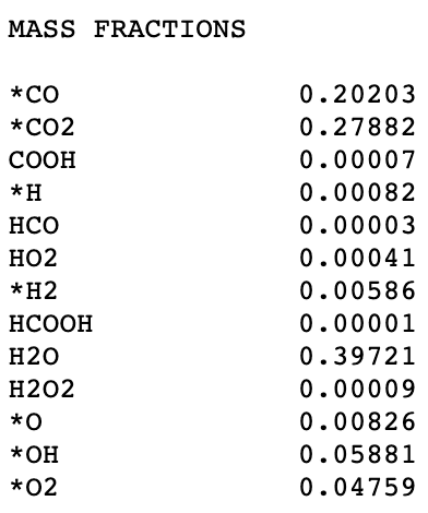

What fuel is your engine running? I'm running CEA to investigate if this sort of a reactant mix of 50% water occurs when. burning either Hydrogen or Methane and neither are occurring naturally in these simulations (equilibrium flow):
Methane/LOX:

Just used SpaceX Raptor and RS-25 designs to see what the reactants came to. Was wondering what your system's unique situation was that gets you to that 50% H2O spot. Thanks
