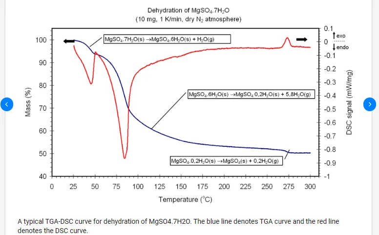

I was thinking of drying some of the epsom salt since I suspect it picks up moisture readily. Then it occurred to me to do what you're saying. It makes far more sense than what I've been doing. But while I think it's safe enough to heat MgSO4 in my kitchen oven to a little over 100°C for a couple of hours I'm not absolutely sure. Ignorance demands a cautious approach.
Is MgSO4 volatile to any significant degree?
Drying hydrates is (almost) never simple, some of these salts have water molecules that can't be removed without destroying the compound itself, some will lose final water molecules at much higher temperatures than 100 °C. To make things worse actual number of water molecules in the sample can be non stoichiometric and depends on the temperature, humidity and the sample history (hydration can be a slow process, so you can be limited by kinetics). There is no simple universal approach to keep the composition of the hydrate exact (then there are some hydrates that are particularly stable, these are often candidates for primary substances in analytical chemistry).
MgSO4 is not volatile at all. The anhydrous salt is a white powder that is quite hygroscopic - chemists routinely use it to remove water from organic solvents. Epsom salts tend to LOSE water at the drop of a hat. Best strategy is to dry it in a pre-weighed glass dish, cover it while it cools, and immediately re-weigh. The challenge is that you need to get it up to almost 500°F to completely remove the water. (Put it under the broiler if you're using a typical household oven.)

Translucent crystal vs opaque powdery is a typical difference between hydrated and anhydrous (doesn't mean it always works this way, and I would never assume something is really anhydrous just because it is white and powdery, but that's a good first guess when you see such an effect).

What happens as it dehydrates at 215°F? What form of salt crystallizes?
I'll try again with my oven set to 550°F and see how it goes.

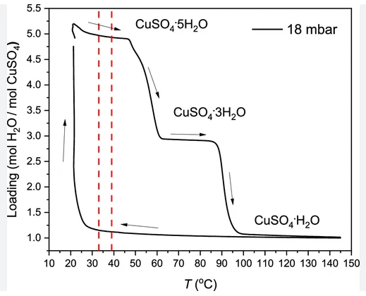

Note: there is always series of hydrates, differing with the number of water molecules, and getting to each next step requires higher temperatures.
Sometimes they are more stable and the thermogravimetric curve (basically you heat the sample very slowly and you register mass of the sample left at a given temperature) looks more like a staircase:
Still, these with lower amount of water typically look more and more whitish and opaque.
