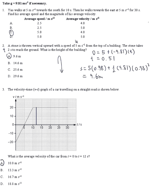

Hi everyone, because I am on vacation right now. So, I'm prepping for the topic of kinematics. I've done some exercises(not homework or graded assignments!!) , but since the teacher hasn't taught it yet, I don't know if the answers are right, so I hope someone here can help me check the answers. Thanks! ☺️

All the answers for question 3 are wrong.
I think so coz I found the avg. velocity to be 11.7 .
Except Q3, do I get the questions(question1-30) all correct? thanks
No, that is the average speed.
I didn't look at all the questions.
Question 3 should be asking for the average speed.

The average speed is 11.7 m/s, not the average velocity. Do you know the difference between the two? Question 1 supposedly tests whether you do.

for Q3, it should be ''avg. velocity: [(5)(-20)÷2 +(2+7)(20)÷2]÷12 = 3.3 m/s'', right?
That's okay, but it's not a good way to write things. You ought to explicitly mention the (signed) area under the graph and the total time.
I would also have a criticism of these questions. It would make much more sense to me to calculate the displacement at ##t= 12 \ s##. That's the key point. Also, that at ##t = 10 \ s## the object is back where it was at ##t = 0 \ s##.
IMO, that's the sort of information that it's important to get from a graph like that.

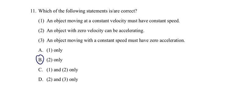

I’m sorry. May I know whether my ans is correct or not? I think (1) & (3) are wrong because velocity and acceleration get direction(vectors) while speed doesn’t(scalar). Thank you.

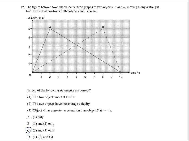

I would like to ask Q19 as well. Thanks.
(2) is correct because A&B have the same total displacement and they finish it with the same time 10s so the two objects have the same avg. velocity.
(3) is correct because at t=1s, the slope of A is greater than the slope of B, which means A has a greater acceleration than B at t=1s.
Your reasoning is incorrect. The easiest way to show that a statement is incorrect is by providing counterexamples.
1. An object moving at constant velocity must have constant speed. This asserts that ALL objects moving at constant velocities have constant speed. To argue that this is incorrect, you must provide an example of an object moving at constant velocity the speed of which is clearly changing with time. Can you think of one? If you can, then the statement is false.
2. An object with zero velocity can be accelerating. Unlike the previous statement this asserts that an object with zero velocity may or may not be accelerating. Can you provide an example where an object with zero velocity IS NOT accelerating and another example where an object with zero velocity IS accelerating? If you can, then the statement is true.
3. An object moving with a constant speed must have zero acceleration. This asserts that ALL objects moving at constant speed have zero acceleration. To argue that this is incorrect, you must provide an example of an object that moves at constant speed the acceleration of which is clearly not zero. Can you think of one? If you can, then the statement is false.

Your reasoning is correct here. Why do you think that choice 1 is incorrect? What is your argument that the two objects do not meet at t = 5 s?
coz their displacement are not equal
I don't disagree with you, but what evidence do you have to support your assertion? As a beginner, you must get into the habit of supporting your assertions using the evidence that you are given.
So what is the evidence that the displacements are different?
since the area of A from t=0s to t=5s and the area of B from t=0s to t=5s are different.
