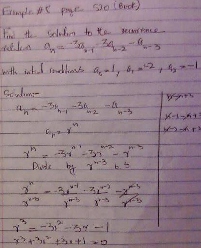

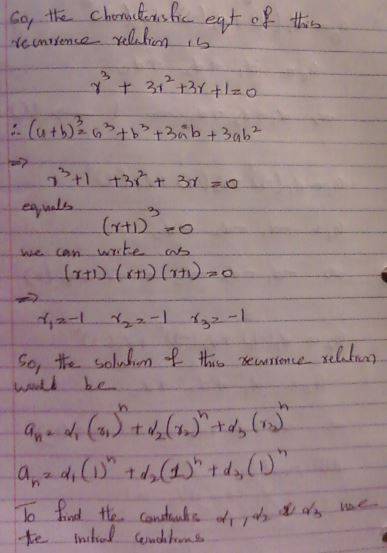

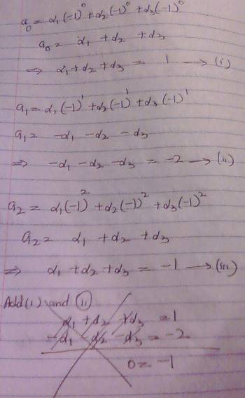

The book answer is 1, 3 and -2. I can't figure how they got it? Please help to understand and help me to get through where i got stuck.
Please look at images from bottom page to top page(where you see crossing on a page)

You have correctly found that the characteristic root is $r=-1$ of multiplicity 3, however, you have not properly dealt with the fact that the root is repeated. Since this root is of multiplicity 3, the closed-form will be:
$$a_n=c_1(-1)^n+c_2n(-1)^n+c_3n^2(-1)^n=(-1)^n\left(c_1+c_2n+c_3n^2 \right)$$
Thank you for your feedback. I noticed that. I forgot to stick "n" in the general form of the solution with the repeated roots. Thanks though!
