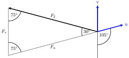

Resolve F2 into components along the u and v axes and determine the magnitudes of these components. Note that the magnitudes are positive numbers.
Basic Trigonometrics
I correctly calculated 150cos(150)N or 130N as the positive magnitude for F2 along the U axis however I cannot figure out what it is along the V axis.
I tried 150sin(150)N or 75N at first and got it wrong. Then I realized that the axis are not orthogonal so I corrected for that and got 150cos(75)N or 38.8N but that is also counted as wrong.
I am mildly annoyed since this is basic stuff so I am assuming I am just missing something obvious. Thanks for any help.

Let's see. We have:
From the sine rule it follows that:
$$\frac{F_u}{\sin 75^\circ} = \frac{F_2}{\sin 75^\circ}$$
$$\frac{F_v}{\sin 30^\circ} = \frac{F_2}{\sin 75^\circ}$$
With ##F_2=150\text{ N}## we get that ##F_u = 150\text{ N}## and ##F_v = 77.6 \text{ N}##.

Let's see. We have:
Interesting, but I'm not sure what Fu and Fv correspond to in your diagram.
The problem statement says: 'Resolve F2 into components along the u and v axes and determine the magnitudes of these components.'
Fu and Fv are the magnitudes of the components of F2 along the u and v axes.

How can the component of F2 along u equal F2 itself?
And the angle that F2 makes with the vertical is 75°, so Fv = F2 cos(75°). (What you have labeled Fv in your diagram is not the vertical component of F2.)

We can also write:
$$\mathbf F_2 = \mathbf F_{2,u} + \mathbf F_{2,v} = F_{2,u} \mathbf{\hat u} + F_{2,v} \mathbf{\hat v}$$
where ##\mathbf{\hat u}## and ##\mathbf{\hat v}## are the unit vectors along the u and v axes.
After which we have ##F_u = |F_{2,u}|## and ##F_v = |F_{2,v}|##.
We can have a component of F2 along u equal F2 since u and v do not form an orthogonal basis.
The vector decomposition is effectively shown in the diagram.

That would only be the case if we had an orthogonal basis (which is admittedly usually the case but not here).
The component of F2 along u can equal F2 only if F2 is parallel to u. That's not the case here.
