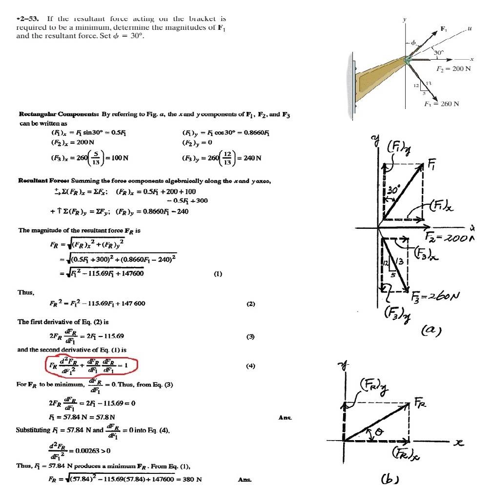

Hello! :)
Here's another problem that I want to fully understand how it was solved.
The part that I'm having a hard time with is the taking-derivatives of some equations. Why did the solver decide to take the derivative of equation 2. And why the second derivative of equation 1 became like that(encircled with red)?
It's the taking-derivatives of things I'm most confused(not the taking derivatives, but the reasoning of the solver why did he take that route.) THANKS!

The problem is looking for the minimum [math]F_R[/math], which requires us to take a derivative. (The derivative of a function is 0 at a relative minimum point.) So we set the 1st derivative to 0. Once that is done we need to see if the value of [math]F_R[/math] given by the 1st derivative is a relative minimum or a relative maximum. The 2nd derivative test does this.
As for the second derivative:
The first derivative equation is:
[math]2F_R ~ \frac{d F_R}{d F_1} = 2F_1 - 115.69[/math]
Taking the derivative with respect to [math]F_1[/math]:
[math]2 \frac{d F_R}{d F_1} \cdot \frac{d F_R}{d F_1} + 2 F_R ~ \frac{d^2 F_R}{d F_1 ^2} = 2[/math]
Now just divide by 2.
(The derivative of the LHS is done by the product rule: [math]\frac{d}{dx} f(x)g(x) = \frac{df}{dx} g(x) + f(x) \frac{dg}{dx}[/math]. Also note that I have taken the derivative on the LHS in a different order than your source so it matches the "usual order" when using the product rule.)
-Dan

Just want to ask how did the solution arrive at the part where it substitutes $F_{1}=57.8$(which, I suppose the critical point of the first derivative) and $\frac{d F_R}{d F_1}=0$ to the 2nd derivative.
$\displaystyle \frac{d F_R}{d F_1} \cdot \frac{d F_R}{d F_1} + F_R ~ \frac{d^2 F_R}{d F_1 ^2} = 1$ I only see $\frac{d F_R}{d F_1}$ but not $F_{1}$, where I can substitute their values.
which results in
$\frac{d^2 F_R}{d F_1 ^2}=0.00263>0$ --->>> how did it arrive here? I know what this result means, it tells us the point of minimum. But I don't understand how did that happen.

Hi Drain Brain:
In the solution notice that equation (2) gives a relation between FR and F1. Once you have F1, simply find FR using equation (2) and replace into the 2nd derivative relation.
