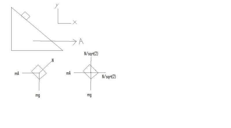

A 45 degree wedge is pushed along a table with constant acceleration A. A block of mass m slides without friction on the wedge. Find its acceleration.
I quick sketched up the problem in the attached picture. It seems very simple but I'm left with the wrong answer in the end when I use a test value - I'll state later. By looking at the block's position and wedge's position at a later time with respect to the start point, one can derive the following constraint equation:
[tex](h-y) = (x-X) \cot(\theta) \implies -y'' = x'' - A \implies A = x'' + y''[/tex]
where h is the height of the block.
The test value is "If A = 3g, y'' = g " and so I need to eliminate the x'' term from the constraint equation using the force diagram. Taking y and x to be positive to the north and east, we have:
[tex]mx'' = \frac{N}{\sqrt{2}} - mA \implies x'' = \frac{N}{m\sqrt{2}} - A[/tex]
[tex]my'' = \frac{N}{\sqrt{2}} - mg \implies y'' = \frac{N}{m\sqrt{2}} - g[/tex]
[tex]\frac{N}{m\sqrt{2}} = x'' + A = y'' + g \implies A = y'' - x'' + g[/tex]
But, [tex]A = x'' + y''[/tex], so :
[tex]y'' - x'' + g = x'' + y'' \implies x'' = \frac{1}{2} g[/tex]
(by this point I seriously doubt the validity of my answer, which calls x'' independent of A)
Substituting,
[tex]A = y'' + \frac{1}{2} g[/tex]
Using the test value A = 3g,
[tex]3g = y'' + \frac{1}{2} g \implies y'' = \frac{5}{2} g[/tex]
This does not match the book's answer of y'' = g, and my value of x'' seems intuitively meaningless. What have I done wrong with the forces?

Your horizontal force equation is the problem. There shouldn't be a -mA there. x is the distance to the mass as measured in an inertial system (and NOT from the wedge's origin), and you're also working in an inertial system, so -mA shouldn't be there.

Thanks! I see the mistake now, it works:
[tex]mx'' = \frac{N}{\sqrt{2}}[/tex]
[tex]my'' = \frac{N}{\sqrt{2}} - mg[/tex]
This means:
[tex]x'' = y'' + g \implies A = 2y'' + g[/tex]
Plugging in A = 3g,
[tex]3g = 2y'' + g \implies y'' = g[/tex]
