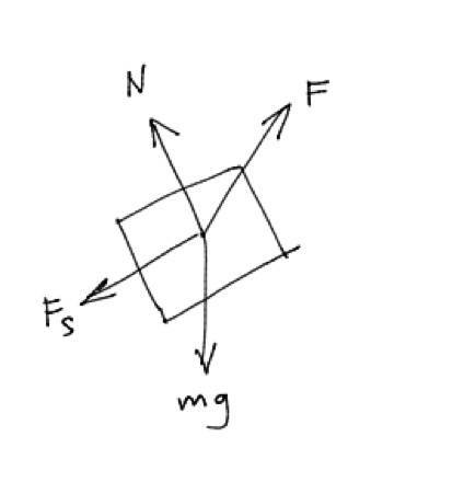

Im not sure where to start? I drew a FBD: perpendicular to slope I have mgcostheta going down and normal force going up perpendicular to slope. F is going to the right and fs is going down to the left. Is this correct?

For normal force, i have N = mg cos theta
i tried attaching the image but it was too big. I'll try again.
ok here is my diagram.

[Edit: 'Just looked at your FBD, and it looks fine. :approve:]

The normal force is the sum of the parallel components of all the other forces (and in the opposite direction of this sum).
You got one of them. mgcosθ is the part of the gravitational force that is parallel to the normal force.
The frictional force has no part that is parallel to the normal force (because the normal force and frictional force are perpendicular to each other).
But there is a part of the pulling force F, that is parallel to the normal force that needs to be considered too. This needs to be part of the sum that makes up the normal force.
(By the way, this might be a good time to try out that rotation idea, at least in your mind, for this particular step. Imagine rotating the whole figure such that the normal force points straight up [you can rotate it back later -- this is just to find the normal force]. Now the normal force points straight up, in the positive y direction. It's x component is zero. Find the y components of all the vectors [including the normal force] and set the sum equal to zero.)
You'll find that the normal force has an mgcosθ which you've already found, and also another term which is a function of the pulling force F.

I went through my calculations again and I got 57N instead of 75.7N.
I summed up all the x and y components:
Sum of Fx = 0 Sum of Fy = 0
Fcos35 - muN - mgsin20 = 0 N - mgcos20 + Fsin35 = 0
therefore, N = mgcos20 - Fsin35
I plugged N into the first equation. Then solved for F.
is that correct?
Yeh! :biggrin: Perfect! :approve:
Great! :approve: You might want to be careful with your precision (significant digits) though. I got something closer to 56.7 N. Still, great job! :smile:
