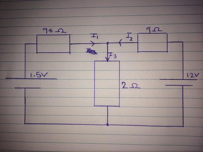

Hi There,
Im trying to revise for a test and I need help with the following question
I need to find I1 I2 and I3,
I only know the voltage and resistance of the 3 resistors
I have drawn the circuit and attached it,
so stuck! please help!
So, what are the equations you get from Kirchoff's current law and voltage law?
i1 - i2 - i3 = 0
and
Vab + Vbc + Vcd + Vda = 0
I think
