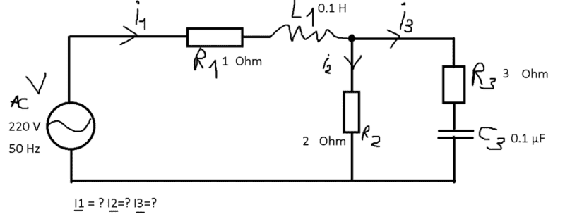

Summary:: Hi, I tried attempting this problem in alternating current in order to find out the phasors as complex numbers, and I would be more than grateful if someone could peer review it, and confirm my calculations (Please see below both the Figure and the calculations)
Please find attached the electrical circuit as a figure.
Given data:
Voltage V220 V
Frequency50 Hz
Resistance R11 Ω
Coil electrical inductance L10.1 H
Resistance R22 Ω
Resistance R33 Ω
Capacitor electrical capacitance C30.1 μF = 10-7 F
I1, I2, I3 =? (Phasors as complex numbers for alternating current)

I am really confused why I3 is so low though, for sure I did something wrong because I3 has negative value both on the real and imaginary part.
I would be more than grateful if someone could check my work as a peer review.

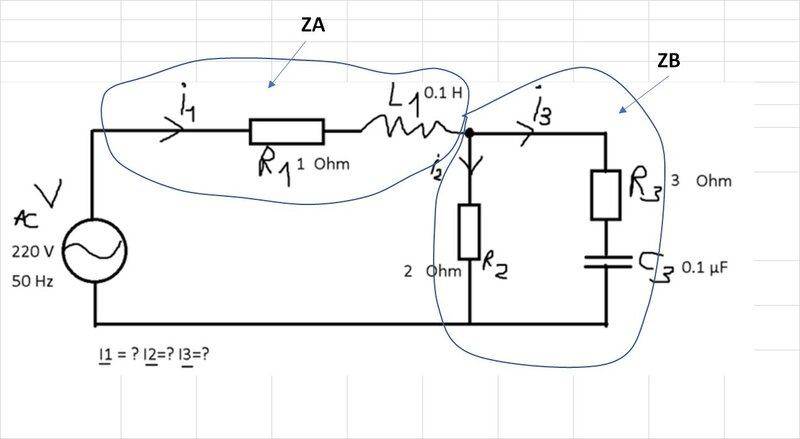

I just checked with a big screen. Eq 3 is wrong. Look at the circuit.
First you forgot part ZA by considering Z=ZB only.
Second in my opinion Z[=ZB]=1.99999998026079-0.000125663703042964i

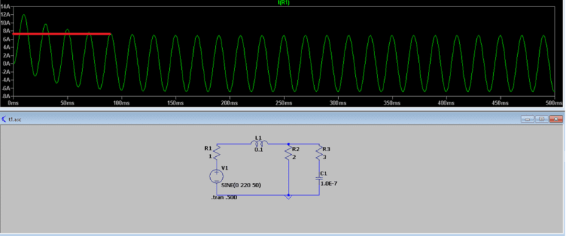

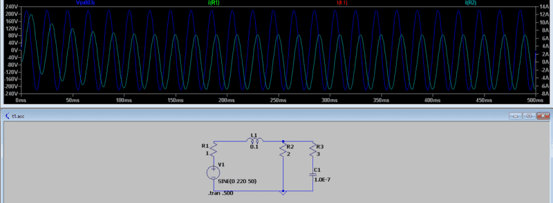

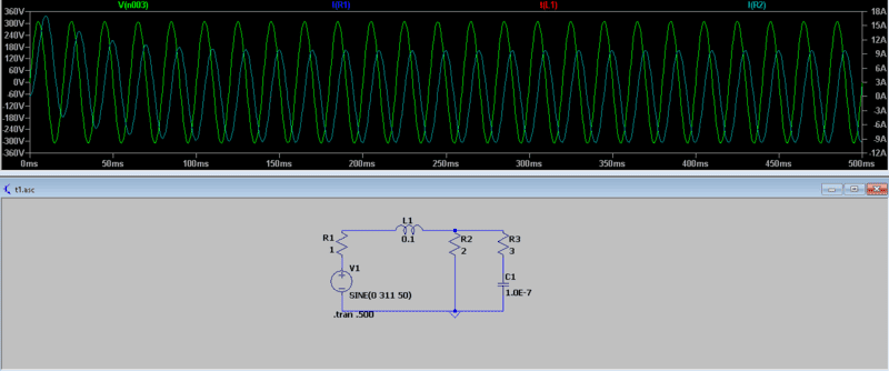

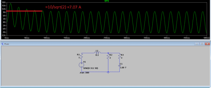

Please find attached the SPICE simulation results for 220V and 311V
are also peak. I was just given 220V though.
Now, I'm confused, am I doing something wrong? Because I assumed 220V is peak and hence the currents
What voltage should I put into SPICE Simulation then? 220V or 311V? Since I want to correlate the simulation with the manual calculations. I'm confused now if the currents calculated by manual work are peak or rms.
A physicist or mathematician might assume; V = 220;
An engineer or technician might assume; V = 220 Vrms * √2;
It really does not matter which you used. They all stay the same.
If it is not specified, make a decision, state it clearly, then stick to it.
Only if you will evaluate power do you need to know if it is Vrms or Vpk.

Now I'm trying to figure out why I1 roughly = I2 and I3 is so small
I think becauseso little current is shunted to the R3C3, hence I2 roughly = I1
Little current I3 because capacitor C3 = 0.1 micro Farad
I mean, what makes it that I3 is so small, hence I1=I2?
From Kirchoff's Law, I1=I2+I3
I3 is small due to Z3, hence I2 has to be roughly I1
Martin Harris said:
I mean, what makes it that I3 is so small, hence I2=I3?
I think you mean, I3 is small, hence I1 ≈ I2.
I3 is small because C1 is small, 0μ1 F.
At 50 Hz, XC1 is huge = -31k831 ohm.
I3 is also lower than you might expect because;
the voltage across Z3 is lowered by the presence of XL1.
XL1 = +31.41 ohm, which is big compared to the 1 ohm of real series resistance in Z1.
Thanks a lot! Yeah, sorry about that, I was thinking of Kirchoff's Law already when I was typing it, so please consider it a typo.
For V2=V3=V23 I got 14V, as I did the magnitude, seems about right I guess (?)
V23 = I1 * Z23 = ( +1.324492280395 -13.879210675423 j ) volt;
V23 mag = 13.9422655 V, phase = -84.548775°.
Yeah, I just rounded it to 14V, but you're more precise! Thanks a lot! By the way how did you get that phase?
I got phase around -80°
Given complex V23 = ( +1.324492280395 -13.879210675423 j ) volt;
Function Amplit( Byval a As complex ) As Double
Return Sqr( a.real * a.real + a.imag * a.imag )
End Function
Function Phase( Byval a As complex ) As Double
Return Atan2( a.imag, a.real )
End Function
Then convert radians to deg.
