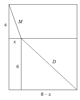

My try:
Find the two triangles:
So 8 miles east and 4 miles south for the marsh.
8-x east and 6 miles south or the dryland.
So:
C(x)= (√(8^2-4^2))(5000000) + 2000000(√((8-x)^2-(6)^2))
Im pretty sure I am doing this wrong.
on Phys.org
I would begin with a diagram:
Also, let's let the cost function $C(x)$ be in millions of dollars. In the diagram $M$ is the distance across marshland, and $D$ is the distance across dry land. Using the Pythagorean theorem, we then find:
$$C(x)=5\sqrt{x^2+4^2}+2\sqrt{(8-x)^2+6^2}$$
So, now you want to equate $C'(x)$ to zero and solve for $x$...what do you find?
Performing the differentiation and equating the result to zero, we obtain:
$$C'(x)=\frac{5x}{\sqrt{x^2+16}}+\frac{2(x-8)}{\sqrt{(x-8)^2+36)}}=0$$
Observing that for all real $x$, we have:
$$0<x^2+16$$ and $$0<(x-8)^2+36$$
we may then multiply through by $$\sqrt{\left(x^2+16\right)\left((x-8)^2+36\right)}$$ to obtain:
$$5x\sqrt{(x-8)^2+36}+2(x-8)\sqrt{x^2+16}=0$$
which we may arrange as:
$$5x\sqrt{(x-8)^2+36}=2(8-x)\sqrt{x^2+16}$$
Square both sides (and keep in mind in doing so we may introduce extraneous solutions):
$$25x^2\left((x-8)^2+36\right)=4(x-8)^2\left(x^2+16\right)$$
Distribute:
$$25\left(x(x-8)\right)^2+900x^2=4\left(x(x-8)\right)^2+64(x-8)^2$$
Arrange as:
$$21\left(x(x-8)\right)^2+900x^2=64(x-8)^2$$
Square binomials:
$$21x^2\left(x^2-16x+64\right)+900x^2=64\left(x^2-16x+64\right)$$
Distribute:
$$21x^4-336x^3+1344x^2+900x^2=64x^2-1024x+4096$$
Arrange quartic polynomial in standard form:
$$21x^4-336x^3+2180x^2+1024x-4096=0$$
Using a numeric root finder (and discarding complex and negative roots), we obtain:
$$x\approx1.25290753523819$$
To ensure this is not an approximation of an extraneous root, we should check it:
$$f(x)\equiv5x\sqrt{(x-8)^2+36}\implies f(1.25290753523819)\approx56.5626548992099$$
$$g(x)\equiv2(8-x)\sqrt{x^2+16}\implies g(1.25290753523819)\approx56.5626548992098$$
This approximation checks out. Now we need to show that this critical value minimizes the cost function. Using the first derivative test, we find:
$$C'(1)=\frac{5}{\sqrt{17}}+\frac{2(-7)}{\sqrt{85}}=\frac{5\sqrt{5}-14}{\sqrt{85}}<0$$
$$C'(2)=\frac{5}{\sqrt{5}}+\frac{2(-6)}{6\sqrt{2)}}=\frac{5\sqrt{2}-2\sqrt{5}}{\sqrt{10}}>0$$
Thus, we know the critical value is at a minimum.
Now to find the savings realized by using this value of $x$ rather than using a direct route between the two points, we first need to find the value of $x$ in this scenario, and we can use similarity to do so:
$$\frac{4}{x}=\frac{6}{8-x}\implies x=\frac{16}{5}$$
And so the savings $S$ (recall this is in millions of dollars) is found by:
$$S\approx C\left(\frac{16}{5}\right)-C(1.25290753523819)\approx1.963789989453947427$$
And so the savings to the nearest penny is: \$1,963,789.99.
