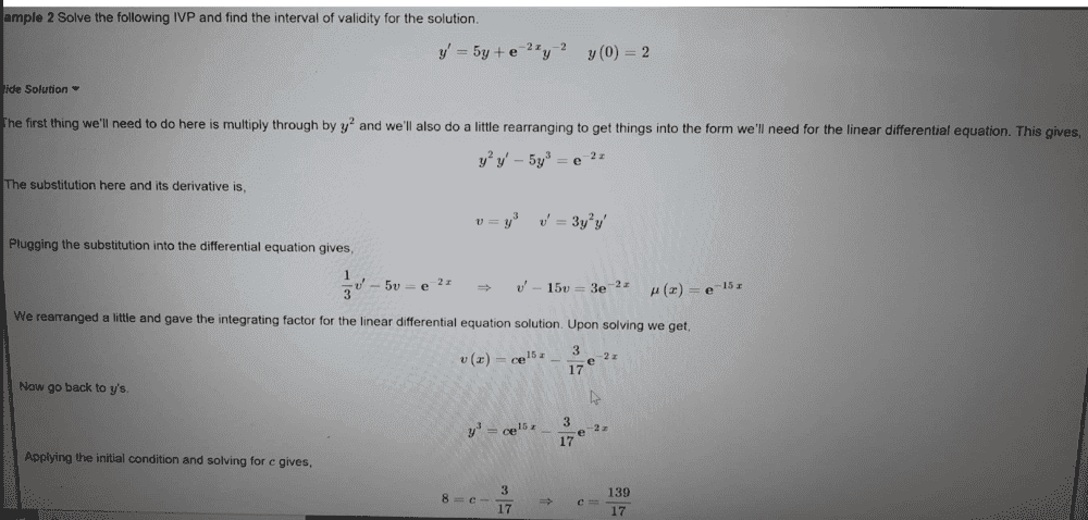

Screenshot of a textbook worked example solving the IVP y' = 5y + e^(-2x) y^(-2) with y(0) = 2, showing the Bernoulli substitution v = y^3 and the resulting linear equation v' - 15v = 3e^(-2x).
kindly note that my question or rather my only interest on this equation is how we arrive at the equation,
##v(x)=ce^{15x} - \frac {3}{17} e^{-2x}## ...is there a mistake on the textbook here?
in my working i am finding,
##v(x)=-1.5e^{13x} +ke^{15x}##
Try plugging it into the differential equation and see if it is a solution.

I haven't talked about solution...my only interest is on the step of finding ##v(x)##, is my ##v(x)## wrong?
There is an equation for v(x). Plug your v(x) into it.
I got the same as the book. Which is the first step in your solution that differs from the solution in the book?
