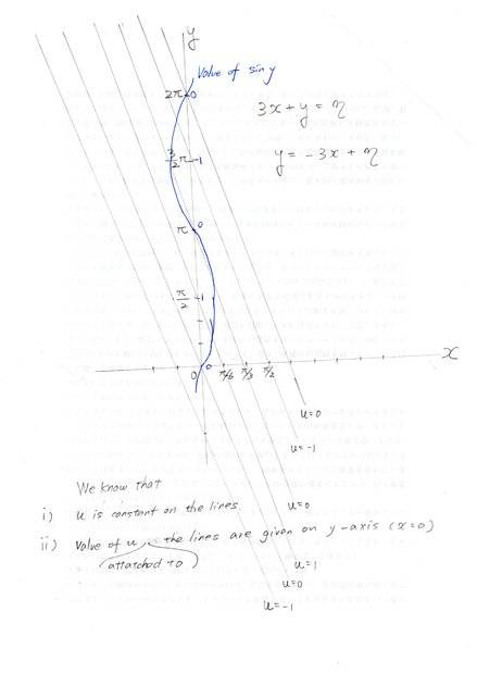

just a quick question, can we also approach this using;
##u(ξ,η )=f(ξ)##
then it follows that,
##u(x,y)=f(2x-6y)##
##\sin y=u(0,y)=f(-6y)##
##f(z)=\sin\left[\dfrac{-z}{6}\right]##
##u(x,y)=\sin\left[\dfrac{-2x+6y}{6}\right]##

It is interesting on how you applied the boundary condition here... my understanding is that it applies to ##u(x,y)## looks like in your case it applies to ##η(x,y)##...the steps before this are quite clear.
Reply
Please find attached the sketch for explanation. Best.

From this
[tex]u_x=-\frac{1}{3}\cos\{-\frac{x}{3}+y\}[/tex]
[tex]u_y=\cos\{-\frac{x}{3}+y\}[/tex]
So [tex]-3u_x=u_y[/tex]
which is diffent from the problem statement.

@anuttarasammyak can you kindly show how you applied the boundary conditions? As requested in post ##4##...
