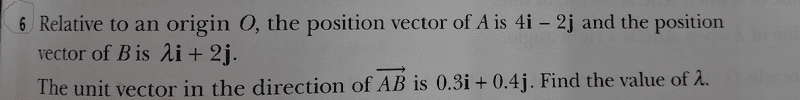

see attached
vectors
This is a textbook problem, the text book solution is ##λ=7## I think this may not be correct, unless the thinking of gradient was applicable, i.e since they lie on same straight line then the gradients should be the same
i.e ##\dfrac{0.4}{0.3} = \dfrac{4}{λ -4}##
in this case then
##\dfrac{4}{3} = \dfrac{4}{λ -4}##
##λ=7##.
Otherwise, using algebra, unit vector of ##\hat {AB} = \dfrac {\vec {AB}}{ |\vec{AB}|}##
i got the equations,
for ith component,
##\dfrac{λ-4}{\sqrt{(λ-4)^2+16} }= 0.3##
and
for jth component,
##\dfrac{4}{\sqrt{(λ-4)^2+16}} = 0.4##
##\sqrt{(λ-4)^2+16}=\dfrac{4}{0.4}##
##\sqrt{(λ-4)^2+16}=10##
##λ-4 = ± \sqrt 84##
not an integer value...
A(4,-2) B(l,2)
AB vector (l-4,4)=(3,4)=10(0.3,0.4)
l=7
On the other hand, using scale factor, we have the unit vector as ##0.3i + 0.4 j##, its magnitude is ##0.5##
The vector ##\vec AB ## is 10 times the unit vector. Therefore the magnitude of ##\vec AB = 10 × 0.5 = 5##
Therefore,
##{\sqrt{(λ-4)^2+16} } = 5##
## (λ-4)^2+16 = 25##
##(λ-4)^2 = 9##
##λ_1= 4+3=7## and ## λ_2=4-3=1##
The root 1 gives AB vector (-3,4) which is not proportional to given (0.3,0.4). This happens because you see only magnitude of the vector.

##0.3i + 0.4 j## is not a unit vector for precisely the reason you show. The magnitude of a unit vector is 1.

The main problem I see is in the problem itself, where it says, "The unit vector in the direction of ##\overrightarrow{AB}## is ##0.3\hat i + 0.4\hat j##. This is not a unit vector. The correct unit vector is ##0.6\hat i + 0.8\hat j##. The value given for ##\lambda## seems otherwise correct.

I don't think you understood what I was saying. The textbook said that 0.3i + 0.4j is a unit vector -- this is incorrect because the magnitude of this vector is 1/2. A unit vector is one whose magnitude, or length, is 1. I quoted the exact text from the screenshot you attached. There are no tricks or scaling needed. For the textbook to say that this is a unit vector is a mistake, pure and simple. Again, their answer that ##\lambda = 7## is correct, but the problem statement includes the typo that I have identified.
