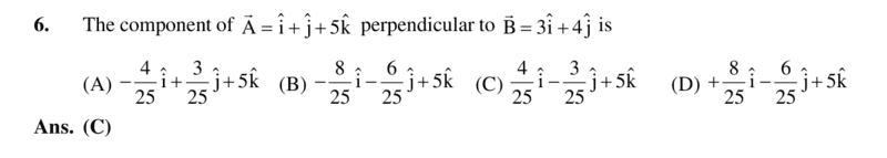

Calculate the component of a vector ##\vec A = \hat i+\hat j+5\hat k## perpendicular to ##\vec B = 3\hat i + 4\hat j##.
1. The vector ##\vec B'## perpendicular to ##\vec B## is such that ##\vec B'\cdot \vec B = 0##.
2. The (vector) component of a vector ##\vec A## along a vector ##\vec B'## is ##(\vec A)_{B'}=(A\cos\theta_{AB'})\hat B##.
Problem statement :
I copy and paste the (slightly different) problem statement as it appeared in the text to the right.
Attempt : By inspection, we find that the vector ##\vec B'## perpendicular to ##\vec B = 3\hat i+4\hat j## is ##\boldsymbol{\vec B' = 4\hat i -3\hat j}##, remembering that for perpendicular vectors ##\vec B## and ##\vec B'##, ##\vec B\cdot \vec B' = 0##.
The vector component of ##(\vec A)_{B'}=(A\cos\theta_{AB'})\hat B'=\left(\frac{\vec A\cdot \vec B'}{B'} \right)\hat B'##.
Now ##\vec A\cdot \vec B'=\frac{1}{5}##, ##B' = B = 5## and ##\hat B' =\frac{4\hat i- 3\hat j}{5}##.
Thus ##\boxed{(\vec A)_{B'}= \frac{1}{25}\left( \frac{4}{5}\hat i - \frac{3}{5}\hat j\right)}##.Doubt : My answer is at odds with that of the text, which I copy and paste below.
Question : I agree to the text's method, viz. ##\vec A = \vec A_{\parallel}+\vec A_{\perp}##. However, I struggle to see what's wrong with my my method either.
You may add [tex]\alpha \mathbf{k}[/tex] to B' and keep it perpendicular to B.
You got answer C. The book solution has a typo in the last line, with a extra factor of 5 in the denominator.
PS I got the solutions mixed up. It's yours that is wrong, with the extra factor of 5.
My answer differs from not having a ##5\hat k## also. So my vector component is confined in the ##x-y## plane. I am wondering if this problem has a unique solution.
It's a given that you include the ##5\hat k##. The solution is unique, as long as you sufficiently define what you mean by component. If we express$$\vec A = \alpha \vec B + \vec C$$Where ##\vec B \cdot \vec C = 0##, then ##\vec C## is uniquely defined. The proof is an exercise if you want.
PS this is an example of what I call a "specific techique". This is where a specific technique is used to solve a specific problem, even where a completely general solution exists. Sometimes, a specific technique may be a significant shortcut. But, at other times, it's no simpler than the general approach.
The most common example is the quadratic equation. There are lots of videos on YouTube showing various techniques for solving specific quadratic solutions. And, yet, a general solution (completing the square) exists. Not to mention the general quadratic formula - which is so ubiquitous that it seems worth memorising!
In this case, the proof of the above (which I'll include here) represents a general technique for solving all such problems. This is certainly the way I look at mathematics. We are looking for ##\alpha## and ##\vec C## (the component) such that:$$\vec A = \alpha \vec B + \vec C$$Where ##\vec B \cdot \vec C = 0##.
First, we see that:$$\vec A \cdot \vec B = \alpha B^2$$Where ##B = |\vec B|##. Hence:
$$\alpha = \frac{ \vec A \cdot \vec B}{B^2} \ \ \text{and} \ \ \vec C = \vec A - \frac{ \vec A \cdot \vec B}{B^2}\vec B$$Let's check that out in this case:
$$\vec A \cdot \vec B = 7, \ B = 5$$$$\vec C = (1, 1, 5) - \frac 7 {25}(3, 4, 0) = (\frac 4 {25}, -\frac 3 {25}, 5)$$That's a general approach to vectors that will not only solve elementary problems, but lay a foundation for more advanced mathematics.
Let's do a simple sanity check here. There is an entire plane perpendicular to ##\vec B##. How did you pick that vector, ##\vec B'##, out of an entire plane with no reference to the vector ##\vec A##? The answer should be unique. That should make you sceptical of your method.

brotherbobby said:
Fair enough. But when we talk of a vector ##\vec B'## that is perpendicular to ##\vec B##, aren't we free to choose any vector?
Yes. However, all of those vectors (##\vec B'##) determine the plane that is perpendicular to ##\vec B##.
No. You better choose the right one if you want it to have the correct component of ##\vec A##. You might pick one with anything from a multiple of the desired component of ##\vec A## to one that is perpendicular to ##\vec A##. How would you know? This approach gets you nowhere. It is much better to start with ##\vec A## and subtract out the part of ##\vec A## that is parallel to ##\vec B##.
Just to be clear, my answer of "yes" was strictly in response to the question about getting a perpendicular vector to a given one, with nothing to do with components.
