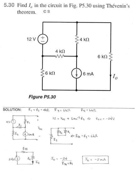

Hey,
For the attached question, the only part I do not understand is why the Thevenin Resistance is equal to R3.
I thought it would be (R1 || R2) + R3
Can somebody please explain this?
cheers!

lol i also think wat u think(dont count on that though my ckts suck)...do tell me too why it isnt:d
The second hand drawn figure shows it. R1 and R2 are not in parallel. They are in series and their series connection is in parallel with a short circuit, so the equivalent resistance of this connection is zero.
