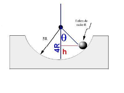

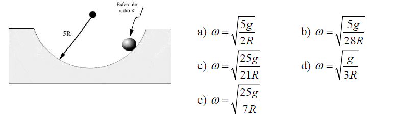

Esphere of radious R which oscilates inside a cylinder of radious 5R.
Calculate the angular frequency for small oscilations.
I hate Newton to solve SHM problems where weight is acting so I opted for energy but I cannot find out what's the gravitationall energy:
\displaystyle E=\frac{1}{2}I{{\omega }^{2}}+\frac{1}{2}M{{v}^{2}}+Mgh
\displaystyle E=\frac{7}{4}M{{{\dot{x}}}^{2}}+Mgh
Plz helP! Thanks!

Assume a small angle from the vertical for the sphere release point. The height is the difference in elevations of its center of mass as it moves from the release point to the bottom of the cylinder.
How is that written down as the gravitational energy? I'm really confused. The problem doesn't say anything about the release point so I don't know the height
Thank you
Could you please type the equation for energy? I have a test in 2 hour and I'm in a hurry.. I need to understand this. just this time please!
Alright, now I wrote:
\displaystyle E=\frac{1}{2}I\dot{\theta }+\frac{1}{2}M{{\left( \dot{\theta }R \right)}^{2}}-4R\cos \theta Mg
But the result I got is not option B ! I get that the angular frequency is 10g/3R

Hello Hernaner28,
The energy equation you wrote in the attempt section of your opening post is correct.But you are misinterpreting it I suspect by the looks of your method.This is angular SHM no doubt.But which angle is involved here? The elevation from central line or that in the body?
As LawrenceC says you need to know what actual height of your Center of Mass is.The body is translating and rotating at the same time , so for the sake of energy conservation for a SHM you need to assume it is rolling.Then frame the necessary condition for rolling and you are done.

The small ball performs small oscillations around its equilibrium position, that is, the deepest point. So it is practical to define the angle variable from that point, as in the picture to ensure it small. Also you can define the zero of gravitational potential energy from he deepest position of the CM.
When writing up the kinetic energy attributed to the motion of CM its velocity is the radius of the circular motion (4R) times dθ/dt . You wrote Rdθ/dt.

And the correct option for you to know is B.
You took theta as the angle of rotation of the sphere, did you? In that case, multiplying with R is correct in the kinetic energy terms, but revise the potential energy.
ehild
Theta is the angular displacement of the ball as if it was a pendulum. The angle you shown in your diagram. But why is the potential energy wrong? I took that the potential energy in the equilibrium position (vertical) is -4R. So the potential energy when the ball has displaced an angle of theta is -4Rcos(theta).
Thanks
If theta is the angle shown in my diagram then it also shows the position of the CM of the sphere. The CM of the sphere moves along a circle of radius 4R. Its speed is 4Rdθ/dt.
ehild
