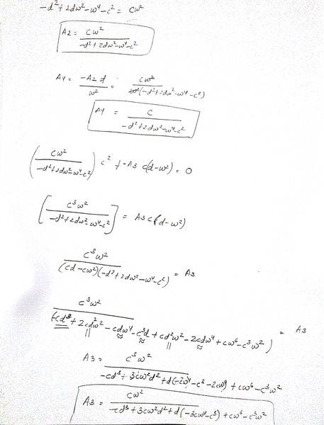

Solve the following system of equations
A1 + A3 = 0
cA1 + A2 + A4 = 0
dA1 + cA2 + w^2 A3 = 1
dA2 + w^2A4 = 0
https://imgur.com/YSG5oGN - Page 1
https://imgur.com/dGbccsE - Page 2
I checked with Mathematica. Your expressions for A2 and A4 are correct. Your expression for A3 is not.
Knowing that, the OP should be able to easily fix A1 and A3.
I agree. This particular system lends itself to using Cramer's rule because of all the zeroes on the right hand side.

Here is your Page 1:
Here is your Page 2:
