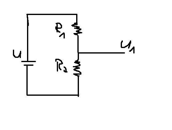

I want so show that U1=U*R2/(R1+R2) (sorry latex didn't work for me right now, don't know why)
I know the solution but I don't understand one step:
The solution says the following: the fall of voltage at U1 = R2*I (I is the current which comes from U). Why is that? Thats doesn't make sense to me, because I thought the current "splits" at this spot so I have: I=I1+I2.
Why does the solution say it's U=R2*I
Thanks for the help

well u is the emf of the source right ?
but what is this ---------u1 ? wat's U1
I don't know how to describe it properly in english, but I think it's the voltage which drains off. I think the english term is voltage divider. But as I'am writing this I think I oversaw something.
The resistances are in series so the current is everywhere the same. Is this the right solution for the problem?
That's because the current does not really split.
The point where U1 is measured is not attached to anything, so no current flows.
This is indeed *only* a voltage divider.
Of course, when something (significant) is attached, the currents and voltages will change.
Ok, I didn't recognize that I have to handle it this way. Thanks for the help
