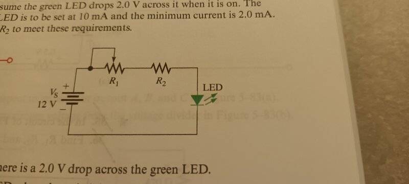

Refer to the figure. Assume the green LED drops 2V across it when it is on. The maximum current in the LED is to be set at 10mA and the minimum current is 2mA. Choose values for R1 and R2 to meet these requirements.
V=IR
Here is the figure mentioned above.
My thinking is that for maximum current, resistance must be minimum. Thus, R1 is not considered which means the voltage drop of R2 is 10V. So, R2 is 1kohm. For minimum, I=2mA, so R1+R2=5kohm, since R2 is 1kohm, R1 must be 4kohm. This is how I deduce. However, the answer shows that R1=5kohm while R2 is 1kohm. I do not understand why it is so. Could someone help me explain why? Thank you as always.
Lay1 said:
For minimum, I=2A, so R1+R2=5kohm, since R1 is 1kohm, R2 must be 4kohm. This is how I deduce.
Change the I=2A typo to I=2mA and I agree with you. I think the solution's answer for the minimum current case is incorrect.

Wait, did you see where there are other typos as well? Please reply with the correct values for R1 and R2, where R2 is the fixed resistance to define the maximum current, and R1 is the variable resistance to define the minimum current when added to R2.
My answer: R1=4kohms and R2=1kohm
The textbook answer: R1=5kohms and R2=1kohm

Oh, okay, I see that now. I still agree with the two values you calculated.
