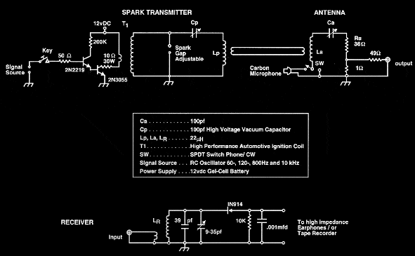

1. Hello, I am making this project ( a spark transmitter and a receiver), my problem are those coils below ( Lp, La, Lr). How are they connected to the circuit.
three images are attached for the detail
please help me
thanks

Lp and La are most likely transformers, and it isn't a connection, rather it works on the principle of mutual induction.
I'm not really sure what is going on with L_R.
From the looks of it, this circuit will probably be relatively expensive to make. Do you have to know how it works?? That could also be hard for someone without much circuit experience. That's a strange transistor configuration, and I myself would have to work it out more.

The transistors aren't problem because I can buy some from the electronics store ( I already asked if they have some, they cost not even a dollar). Getting the carbon mic is not a problem too. The only problems are those coils I marked above and the 100pf high voltage capacitor, 'ALfa electronic'(store) has 100pf capacitor but low voltage. And Mindscrape, what do you think, what's the ratio between those coils if they are transformers. In the chart about those coils (La, Lp, Lr) is typed 22 microHenries ( henries is measurement for inductors and maybe transformers, but maybe). About the T1, it clearly says it's a transformer ( automotive ignition coil, it's ratio is 1:100 ).
what's the ratio of the transformers?
Sorry I didn't get back to you. I could be wrong about the La, Lp, and Lr being transformers. Lr is definitely confusing. If they are, in fact, transformers you could presumably figure out their ratios by working backwards from the definition of inductance.
Berkman might know better, he is pretty good with circuits. If you still haven't figured it out, and need help really bad I could ask some people I personally know.
Mindscrape, I'm so thankful for your attempts to help, anyway, I solved this problem already, and if you are interested I would upload the solution here. La, Lp, and Lr are some kind of transformers as you said, their primary and secondary windings are one above the other with a thin insulator between them and no core ( like in the Tesla coil, you should wind it by hand usually).
