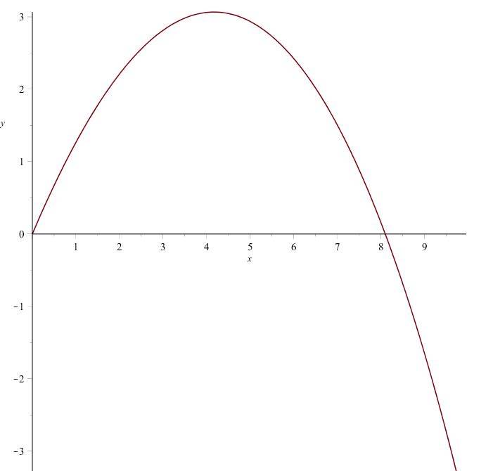

Well I have solved it now, but there seems to be a problem. I solved it in maple and it gave me a (x,y)-graphView attachment 4963
but when i solved it in excel, with your method it gave me a different graph - Can you tell me what I did wrong if I send it to you? :D

Well, I can tell you right away that your formula for cell
Code:
B34,
when you're computing $k_2$, has an error in it. You need to refer back to $k$ directly, and you want the references not to update. So, I recommend changing your
Code:
B29
and
Code:
B30
formulas, the very first part, to
Code:
$B$19,
instead of
Code:
B19.
Similarly, in cells
Code:
B34
and
Code:
B35,
go to
Code:
$B$19,
and so on, to make sure you're always referencing the
Code:
B19
cell for your value of $k$. Otherwise, you're referencing something entirely different. See if that fixes your problem.
By the way, could you please link to your Excel spreadsheet in this thread as well as the PM? Thanks!
Well that is not the problem, because I had already done that in all the next cells - taht was just the first cells...
- I Really can't find the problem... (I have fixed what you said)
Hmm. I can't find the error, either. It looks to me as if you're implementing the formulas above correctly (I checked the first two iterations in detail.)
So, either there's an error in the formulas above, or possibly there's a mistake in the Maple side. I'm afraid I've never used Maple at all, so I'm not sure I'd be much help in seeing if you're doing it correctly there. Your graph seems fairly reasonable.
