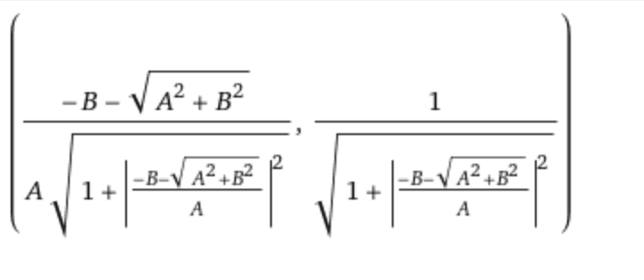

For the normalization, I must divide the vectors by their norm. Since writing this vector via Latex is very time-consuming, I have calculated this with Mathematica, instead of the triangle, I have simply written an A. For the eigenvector ##\vec{\psi_1}## I got the following:
Since this eigenvector looks very messy, I am not sure if I have calculated the task correctly now.
First you need to be less confusing with your symbols. Use \Delta for ##\Delta## and not ##\nabla##, ##\triangle## or ##A##.
According to our rules, to receive help, you need to show your work. The derivation of the normalized eigenvectors is straightforward but I cannot guide you to it unless I see what what you did. Try to use LaTeX, but if you must use Mathematica, did you know that you can export its equations in LaTeX?
Addendum on edit:
Your expression for ##|\psi_1\rangle## is not correct because it is not a constant times the unnormalized ##|\psi_1\rangle##. If you factor out the denominator, you are left with $$
\begin{pmatrix}
\frac{-B-\sqrt{B^2+\Delta ^2}}{\Delta} & 1
\end{pmatrix}$$while the unnormalized vector is
\begin{pmatrix}
\frac{B-\sqrt{B^2+\Delta ^2}}{\Delta} & 1
\end{pmatrix}.$$I suggest that you replace the radical with a single symbol, e.g. ##R\equiv \sqrt{B^2+\Delta^2}.## It will make the algebra more transparent.
