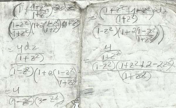

leprofece
239
integral View attachment 2995
This is my work but I got a very looong integral to solve
after substitute tg (x/2) based in my former exercise
it remains 4/ (1-z^2)(3-z^2)
https://www.physicsforums.com/attachments/2996
Each of those can be factorised further and you can apply partial fractions.
However I think it might be possible to avoid the Wierstrauss Substitution...
$\displaystyle \begin{align*} \int{ \frac{1 + \cos{(x)}}{\cos{(x)} \left[ 1 + 2\cos{(x)} \right] } \, \mathrm{d}x} &= \int{ \frac{ \left[ 1 + \cos{(x)} \right] \left[ 1 - \cos{(x)} \right] }{ \cos{(x)} \left[ 1 + 2\cos{(x)} \right] \left[ 1 - \cos{(x)} \right] } \,\mathrm{d}x} \\ &= \int{ \frac{1 - \cos^2{(x)}}{\cos{(x)} \left[ 1 + 2\cos{(x)} \right] \left[ 1 - \cos{(x)} \right] } \, \mathrm{d}x } \\ &= \int{ \frac{\sin^2{(x)} }{ \cos{(x)} \left[ 1 + 2\cos{(x)} \right] \left[ 1 - \cos{(x)} \right] } \,\mathrm{d}x} \\ &= -\int{ \frac{\sqrt{ 1 - \cos^2{(x)} } \left[ - \sin{(x)} \right] }{ \cos{(x)} \left[ 1 + 2\cos{(x)} \right] \left[ 1 - \cos{(x)} \right] } \, \mathrm{d}x } \end{align*}$
Now you could try the substitution $\displaystyle \begin{align*} u = \cos{(x)} \implies \mathrm{d}u = -\sin{(x)} \,\mathrm{d}x \end{align*}$...
Since you're at the home stretch, elaborating on what Prove It said:
$$=\int \frac{4}{(1-z^2)(3-z^2)} \,dz$$
$$=\int \frac{4}{(z^2-1)(z^2-3)}\,dz$$
$$=\int \frac{4}{(z+1)(z-1)(z^2-3)}\,dz$$
Now apply partial fractions. :D
$\displaystyle \begin{align*} &= \int{ \frac{4}{ \left( z + 1 \right) \left( z - 1 \right) \left( z + \sqrt{3} \right) \left( z - \sqrt{3} \right) } \, \mathrm{d}z} \end{align*}$
Ok let's see
this integral is too long according to wolphramalpha
maybe as prove it did it, it is easier
thanks anyway
I'm not Wolfram Alpha, nor a CAS, but the integral does seem manageable.
I was hesitant to factor the $z^2-3$ because it has a known antiderivative, and if you know what that is, it would be easier to split the integral as
Otherwise, if you want to further pursue this problem, work from and here and try partial fractions.
