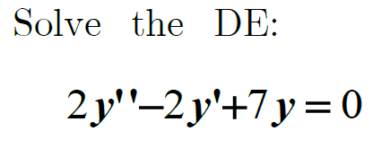

Solve the differential equation with constant coefficients

Printed text reading 'Solve the DE:' above the equation 2y'' - 2y' + 7y = 0.

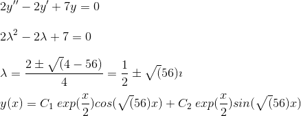

Handwritten-style typeset working for a second-order linear ODE: 2y'' - 2y' + 7y = 0, auxiliary equation 2λ² - 2λ + 7 = 0, roots λ = (2 ± √(4-56))/4 = 1/2 ± √(56)i, and general solution y(x) = C1 exp(x/2)cos(√(56)x) + C2 exp(x/2)sin(√(56)x).
Is my answer correct?

How do you get √56? Shouldn't it be (√52)/4 = (√13)/2?

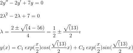

Worked solution of a second-order linear ODE: characteristic equation 2λ² - 2λ + 7 = 0, roots λ = 1/2 ± i√13/2, and general solution y(x) = C1 exp(x/2) cos(√13x/2) + C2 exp(x/2) sin(√13x/2).
Is it correct now ?

1. In the future, please post questions about differential equations in the Calculus & Beyond section. I will move the ones you have posted in the Precalc section.
2. You don't need to ask us to check your work for these kinds of problems. Just substitute your solution in the original diff. equation.
