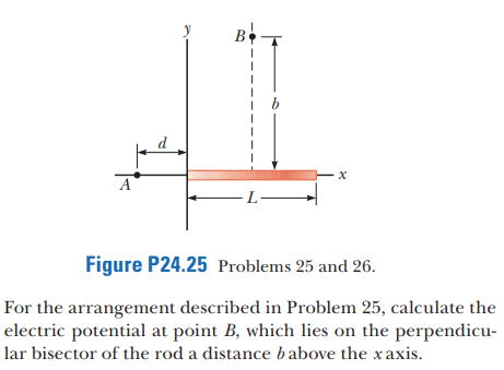

For this problem,

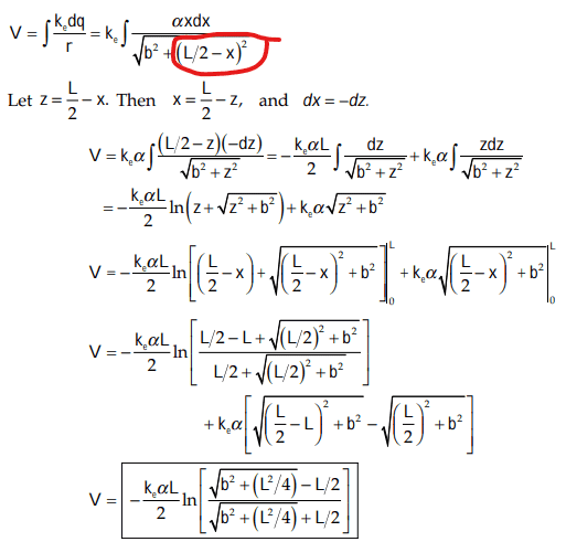

The solution is
However could the bracket circled in red also be ## (x - \frac {L} {2})^{2} ## since the terms are squared? Also if anyone else knows a simpler way to solve this problem please let me know.
I though an easier way to solve this problem would be moving the origin such that it is in the middle of the rod then:
## dV = \frac {k_e dx} {x} ## Then integrate over rod from ## \frac {-L} {2} ## to ## \frac {L} {2} ## to get:
##V = k_e\log_eL ## since ##-In(-L)## is undefined. I guess the authors must of knew this and decided to have the origin at the left of the rod. Anybody else agree with that?
Many thanks!
Yes, it is true that ##(L/2-x)^2=(x-L/2)^2.## Check it out for yourself just be expanding the squares algebraically.

I disagree with that. You wrote ## dV = \frac {k_e dx} {x} .## The denominator should be the distance from a point at distance ##x## from the midpoint of the rod to point B on the y-axis. What is that distance according to the Pythagorean theorem?

Oh I see my error the denominator should be ## (x^2 + b^2)^{1/2} ## since I am finding the potential at a point above the rod. However, are we allowed to solve this problem this way since they defined the origin to the left of the rod not the middle?

Because you dropped the x in the numerator.

Thank you @haruspex ! Looks like I also dropped the alpha too!
## dV = \frac {k_e αx dx} {(x^2 + b^2)^{1/2}} ##
Which I will try to integrate over the rod.

We were not given a complete statement of the problem. we were only given the following, plus the published solution.
In looking at the solution, it's apparent that linear charge density, ##\lambda##, is not constant, but is linear function, going from ##0## at the left end of the rod, to ##\alpha L## at the right end of the rod. As the rod is pictured, lying along the positive x-axis, with one end at the origin, the charge density is given by: ##\lambda =\alpha x## .
If you move the rod to the left, so that it is centered at the origin, you will need to alter the form of the charge density so that it still goes from ##0## at the left end of the rod, to ##\alpha L## at the right end of the rod. That is to say, ##\lambda## will then be given as:
##\displaystyle \quad\quad\quad \lambda =\alpha\left(x+\dfrac{L}{2}\right)##
Therefore, you will need to integrate the following over the length of the rod.
##\displaystyle \quad\quad\quad dV =k_e \dfrac { \alpha\left(x+L/2\right) dx} {(x^2 + b^2)^{1/2}} ##
