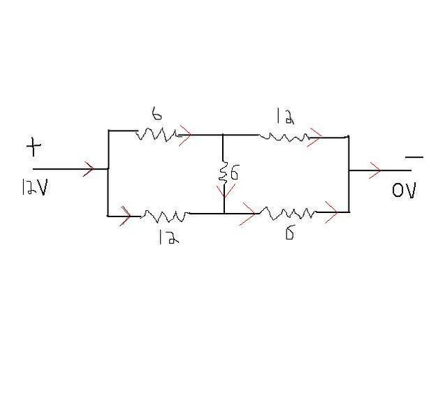

If a 12 V supply is placed across AD, find effective resistance of whole circuit, current through resistor 3, and voltage reading on resistor 5 with polarity
Rn= Resistor number n
I= current
V= volts
I could not figure if the current would flow from c to b, or b to c, because there is no potential difference across it, and therefore could not solve the problem
help please!

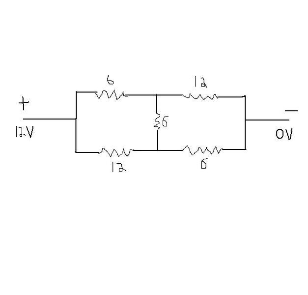

How about drawing it like this...
yeah, after drawing like that I have no clue how to simplify the diagram...my teacher never even went over it.
I also don't know which direction the current flows through in the middle.
if you could show me how, I would appreciate it so much!
http://en.wikipedia.org/wiki/Wheatstone_bridge
Now when you look at this, realize that if Vg exists, then you will have current flowing through that middle resistor in your problem. The nice thing about your problem is you know all of the resistors R1-Rx... They are the ones on the "outside".

The equation tells you which way the current will flow through the middle resistor. Once you know the direction of the through the various parts of the circuit, you need to use kirchhoffs rules. The 5th resistor also comes into play. There is a 5th resistor in the diagram. The way I have it drawn the current should flow down through the middle resistor.
The equation implies that Vg is always determined by subtracting R2/(R1+R2) from Rx/ (R3+Rx) before multiplying Vs. Why can the equation not be (R2/(R1+R2)- Rx/ (R3+Rx) )Vs instead?
I also don't understand how there is a 5th resister...isn't the 5th resister simply R3??
I'm really confused
could you please show me your work? Thanks
And I do get a 6.86V drop across the 12 ohm resistor drawn in your diagram.
This problem requires some time and some calculations. It is difficult for a basic circuit question, but not so if you guys have done Kirchoffs rules. I will put arrows on my diagram that show the flow of current that I figured had to be true due to that link I put up.

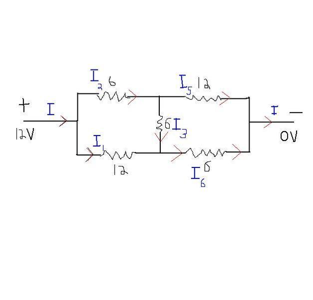

Yes. Kirchoffs loop rule helps you determine the voltage drops. But in order to know these you must know the current. This is found using some algebra and variables for the current in various wires. I will do one example of an equation. But I have to label the different parts of the wires. I will do so using the resistor numbers in your problem.

I understand this.
So I = I1 + I2
I2 = I3 + I5
I4 = I1 + I3
I = I5 + I4
oops relabel I6 as I4; I will fix in the next picture.

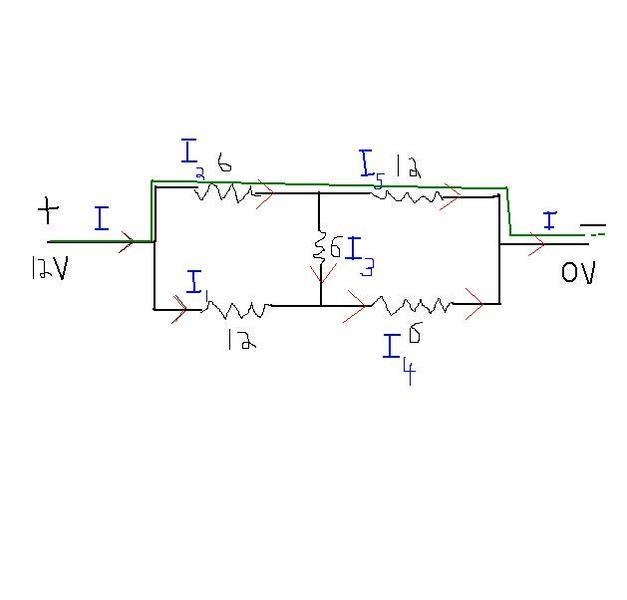

And doing one Kirchoff drop from one end of the battery back to that same point the total voltage drop equals zero: Remember V = R*I
0= 12V - 6 ohms(I2) - 12ohm(I5) this is only one equation. I will now post the path I took in Green.
I get a Voltage drop each time I cross a resistor that has current running through it.
From this we can also conclude that I2 = I4 and I1 = I5
Like I said. Its not hard but it takes some algebra work.
Now if you do another path like I did in the post above, you can figure out exact current numbers and thus by I*R get voltage drops.
