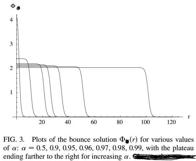

I have been trying to solve the following nonlinear ordinary differential equation:
##-\Phi''-\frac{3}{r}\Phi'+\Phi-\frac{3}{2}\Phi^{2}+\frac{\alpha}{2}\Phi^{3}=0##
with boundary conditions ##\Phi'(0)=0,\Phi(\infty)=0.##
My solution is supposed to reproduce the following plots:

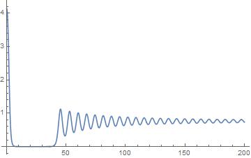

However, my plot for ##\alpha = 0.99## does not converge to the required plot:
Can you suggest how I might tackle this problem for ##\alpha = 0.99##? Also, is there an explanation for the plots shooting upwards and oscillating after a prolonged asymptotic trend towards the positive ##r##-axis?

For ##\alpha=0.99## the decay is very steep and maybe the Runge-Kutta may not handle it very good. Try to use a steep method instead.

Do you mean that the decay for ##\alpha = 0.99## is not reasonable, perhaps because the solution suddenly takes a plunge downwards after being stable for quite a while?
Yes, for problems where you have sudden variations some of the numerical methods won't work. However, you function remembers me of the solution of the cubic-quintic nonlinear Schroedinger equation for which we used some numerical relaxation method to get the top-flat profiles.
So, do you mean that the steep decay itself is not a problem at all, but rather that some numerical methods such as Runge-Kutta do not give accurate plots in such cases?

The shooting method is very simple, but is higly sensitive to the initial condition. You "##\alpha=0.99##" is only an aproximated value because internally the number is stored in floating point convention.
1) try to increase the precision
2) what happens if you increase the total number of iterations ?
3) as your function needs to approach zero (asimptotically) I would test the value ##\Phi(r=130)## against zero, remove the "1.2 comparison".
I think that shooting method shold work here, let's first check that we do everithing right. I never used Mathematica, but only Matlab and some C code from Numerical Recipes. With finite differences you are locked to a fixed mesh and you will to readjust it for each computation (evaluate the spatial extension of the function, how rapidly changes in space), multiple shooting it's shooting with two or more parameters and you can't apply directly the bisection method and the fixed point iteration depends on the problem you want to solve. For the top-flat profiles the finite diferences and fixed point methods need a good aproximation of your solution in order to converge.
