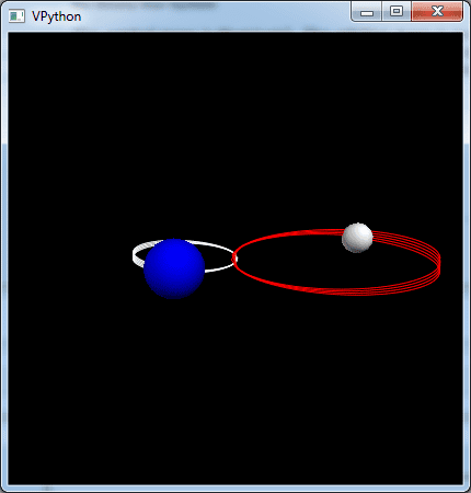

Thanks for the reply! I think I almost have it but something isn't quite right.
Here is what I get when I try to run this:
And here is the code: http://pastebin.com/JBxTjqmy Even if you don't know programming, you should be able to see what I'm doing. Let me know if needs any clarification. Everything after line 28 I know already works from other programs, so I don't think the problem is there. Everything you told me is on lines 18-23
The center of mass is right in the middle and it looks like they are orbiting it, but I think the initial velocity is too small.

My problem was that it needs to be a closed orbit for the period to make any sense, right?
You can use the same program as in the case of the moon orbiting around a fixed earth, and calculate the separate positions of the stars by the formula for vec(r1) = m2/(m1+m2)*vec(r) and vec(r2)=-m1/(m1+m2)*vec(r). This will keep the CM at the origin.
You assumed constant angular velocity, w=2pi/T. That means the orbits are circular. For the single-body problem (like Moon orbiting around a fixed Earth) you can not assume arbitrary distance between the central star and the planet in this case. The centripetal force equals the force of gravity which means that
m r w^2 = gmM/r^2. You can choose either the period or the separation, but not both.
If you have arbitrary initial velocity and position, the orbit will not be circular and the angular velocity will change along the orbit, so that r^2*w= constant. And you have closed orbit if the total energy is negative: 1/2 mv^2-GmM/r^2<0.
ehild
