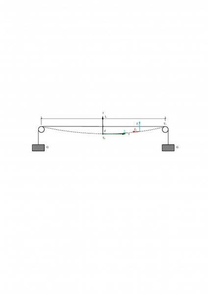

Here is a solution for the following case. Do you agree with ? Thank you in advance for your answer
The question is to give the values of T0 T1 and d in terms of g', L and G in these 2 cases:
1. g'=0
2. g‘ ≠ 0
See attached file..
Proposition:
Cable balance (without counterweight):
The y coordinate (height) of any point in terms of the horizontal force :
y = Th / g’ ∙ (cosh (g’ ∙ x / Th) - 1)
The cable length from origin (center):
s = Th / g’ ∙ sinh(g’ ∙ x / Th)
The total cable length:
S = (2Th / g’) ∙ sinh (g’ ∙ L / 2Th)
The cable span:
L = (2Th / g’) ∙ arcsinh (S ∙ g’/ 2Th)
The horizontal force :
Th = (g’ / 8d) ∙ (S2 – 4d2)
This tension is constant over the entire length of the cable.
The vertical force :
Tv = g’ ∙ S / 2
This tension increases with the height (from the center to the end of the cable)
The minimum tension is, of course, Th, at the center point where the cable doesn't support any of it's own weight.Cable balance (with counterweight)
1. g’ = 0
Tension in the middle of the cable T0
Th = 0
Tv = G
T0 = (Th2 + Tv2)0.5 = G
Tension at the end of the cable T1
Th = 0
Tv = G
T1 = (Th2 + Tv2)0.5 = G
2. g‘ ≠ 0
Tv = G
T0 = (Th2 + Tv2)0.5
T0 = [(g’ / 8d) ∙ (S2 – 4d2)]2 + G2]0.5
Tv = g’ ∙ S / 2 + G
T1 = (Th2 + Tv2)0.5
T1 = [(g’ / 8d) ∙ (S2 – 4d2)]2 + (g’ ∙ S / 2 + G)2]0.5

If T1 is not equal to G, what will happen?
Is g' the weight per unit length of the rope? Please explain where your starting equations come from. Did you derive these or are you taking them as standard?
wah31 said:
I think G is there to balance the cable weight i.e. the vertical component of tension Tv
When a rope passes over a stationary, frictionless pulley, what is the usual relationship between the tension on the one side and the tension on the other?

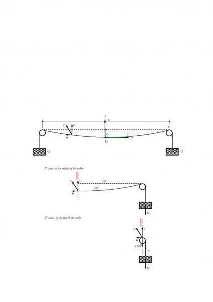

Now if I summarize we get:
For g’ = 0
Th = (g’ / 8d) ∙ (S2 – 4d2)=0
Tv = g’ ∙ S / 2 =0
T0 = 0
Tv = G
For g‘ ≠ 0
Tv = 0
T0 = (g’ / 8d) ∙ (S2 – 4d2)
Tv = g’ ∙ S / 2
T1 = (Th2 + Tv2)0.5 =G
T1 = [(g’ / 8d) ∙ (S2 – 4d2)]2 + (g’ ∙ S / 2 )2]0.5 = G
Is that correct ?
You are getting nonsense answers for the easy case, g'=0. How can the tension in the middle be zero?
I think you are using equations that don't allow for a source of tension other than the weight of the cable.
In theother case, you have S in the answer. You need to eliminate that.
I tried another approach that I believe is the right (see attached file):
For g’ = 0
H = (g’ / 8d) ∙ (S2 – 4d2)=0
V = G (the cable doesn't support any of it's own weight)
T0 = G
V = G
T1 = G
It means that the tension is the same over the entire length of the cable (=G)
For g‘ ≠ 0
V = 0 (the cable doesn't support any of it's own weight)
V = g’ ∙ S / 2
T1 = (H2 + V2)0.5 = G
Now I need actually to eliminate S and present equations in terms of L ?
Do you have an idea ?
