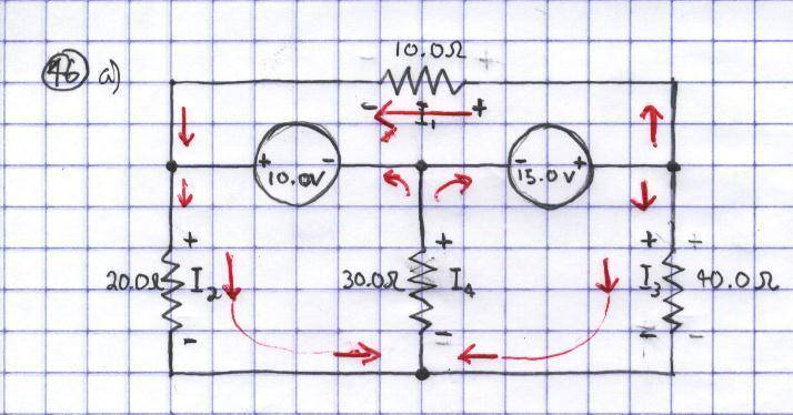

Hi, I'm wondering if I made a mistake in getting the Kirchhoff equations to find all the currents.
Here's what I got:
Loop 1:
[tex]10.0I_1 + 20.0I_2 + 30.0 I_4 = 15.0 V[/tex]
Loop 2:
[tex]40.0I_3 + 30.0 I_4 = 15.0 V[/tex]
Loop 3:
[tex]20.0I_2 + 30.0 I_4 = 10.0 V[/tex]
Current Law:
[tex]I_2 + I_3 - I_4 = 0 A[/tex]
Then I can use Cramer's Rule (heheh) to find each individual current right? I'm afraid I don't know how to make matrices in LaTeX yet. :redface:
  • Hand-drawn circuit schematic on grid paper labelled 4b a, with a 10.0 ohm resistor on top, 10.0 V and 15.0 V sources, and 20.0, 30.0 and 40.0 ohm resistors labelled I2, I4 and I3, with red current arrows.
Eek, why not just ref the matrix with your calculator??
[tex]\left(\begin{array}{ccccc}10&20&0&30&15\\0&0&40&30&15\\0&20&0&30&10\\0&1&1&-1&0\end{array}\right)[/tex]
That column of mostly zeros looks interesting if one were to do it by hand...

But is this system of equation compliant with the attached circuit drawing?

Your equations seem good to me, but your picture has your resistors labeled I2 and I4 with the +,- backwards. Based on how you have them drawn, they would be negative voltages.
Tell me what answers you get and I will compare it to what the computer simulation tells me. (im too lazy to do it by hand :smile:)
Whoops, I4 was backwards, but not I2 though. So there's no I5 and I6 for each of the voltage sources?
Your right, sorry I2 is fine. There is an I5 and I6, but you do not know them because you do not know the resistances. You can find the values of I5 and I6 by going back and applying KCL at each of the nodes after you find all the currents (if you want to.)

Whoa! I think this problem has been made complicated. I think I1 is the easiest current to find, as it has a potential difference of 5V across it.
I would recommend using nodal analysis to find the other currents, as it is a linear equation with 1 unknown variable. The only node where you don't know the voltage is the dot at the bottom of your diagram.

I'm at a loss. How is it that the top resistor at I1 has only 5.0V? Can you explain? So I only need to use Cramer's Rule for I2, I3 and I4? (I4's polarity is wrong in the diagram)
Thanx
You know that the potential at the right side of the resistor is +15V and the left side is at +10V, because the two cells are either side of it and they have their 0V at the same node (they are connected together).

I would urge caution in saying that they have their 0V at the same node. You do not know that the - is zero volts. All you know is the potential difference across the sources is 15V, you have no information what it is on each end relative to ground. For all you know it could be 10V-0v and -15v and 0 V. Then it would 0V and -15V adjacent to each other, and not both zero.
All potential is relative, I didn't say it was 0 V relative to ground. Ground is the usual reference for zero, but I used it as the lowest point of potential, so there are no negative voltages. I always try to simplify things before using maths, it makes life easier.
As for Kirchoff's current loops, now there only need to be 2 loops, so that is a simulaneous equation with only 2 unknowns. I am surprized though that Loops are taught before nodal analysis.
Sam
Why, loops are the most basic forms. Node analysis is derived from KVL and KCL. You can't do it without first knowing loops.

It doesn't matter what way you have drawn your diagram, I always draw the current direction in whatever way I feel; the beauty is that if you've drawn it in the wrong direction, it doesn't matter, you just a negative answer.

ARGH! I've been wasting my time. :cry:
I'll simply row-reduce this matrix and call it quits.
[tex]\left(\begin{array}{cccc}0&40&30&15\\20&0&30&10\\1&1&-1&0\end{array}\right)[/tex]
Zat ok?
Using Cramer's rule to solve a system of linear equation is madness. Gaussian elimination is way more efficient.
Also, using KCL at the nodes and substituting the V-I relation immediately is often easier (no loops!) and faster, but that's my opinion.
I'm getting a negative value for [tex]I_5[/tex] (At the 10V voltage source in the direction of the diagram. I didn't label it before the scan) . Did I make a mistake?

If you get a negative answer, it doesn't mean you got the answer wrong, it could be that you drew the current in the other direction.

Yea, I know about this. I was just surprised that the current of the 10.0V voltage source was occurring in the in the opposite way of the indicated poles. I guess how the 15.0 V voltage source was placed outdid the 10.0 V one. At the end I still considered both voltage sources to 'exert' positive power, otherwise it didn't sum up with the power that the resistors absorbed and converted into thermal energy.
