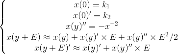

Solve the following equation for x(y). (use no differential functions)
x(0)' and x(0) are known.
I'm a bit unsure as to what to do next but I can easily make a messy formula up to approximate the result.
k1 and k2 are a constant value.
The bigger E is, the bigger the error. For an infinite recursive use of this formula with an infinitesimal E the right result would be achieved. I don't know what it converges to though.
Any help for this problem or/and similar problems would be great. Thank you.

the equation does not contain explicit dependency on y, so try multiplying both sides on dx/dy. You'll get a sort of "conservation of energy" for the problem:
(dx/dy)^2/2 + 1/x = const
const depends on the initial conditions. This way you are left with solving 1st order diff equation

It means that I want something with which I can calculate values directly. I do not want Integrals or Derivatives in my final formula and I think this is very much possible.quZz:
I'm not sure what you mean by explicit but for a given k1, k2 and y there's a single well defined value of x.
Also I'm sorry I'm not very good at handling differentials, I don't even have much practice with calculus. I don't understand how you got that from multiplying the first equation by dx/dy. (assuming that was what you did?)

Your equation is
\frac{d^2x}{dy^2}= x^{-2}
As quZz said, y does not appear explictly so you can use "quadrature". let v= dx/dy. Then
\frac{d^2x}{dy^2}= \frac{dv}{dy}= \frac{dv}{dx}\frac{dx}{dy}= v\frac{dv}{dx}= x^{-2}
That is now a separable first order equation:
v dv= x^{-2}dx
\frac{1}{2}v^2= -x^{-1}+ C
v^2= 2(C- x^{-1})
v= \frac{dx}{dy}= 2\sqrt{C- x^{-1}}
which is also a separable first order equation:
\frac{dx}{\sqrt{C- x^{-1}}}= 2dy

Edit: There's a slight mistake on the your result by the way, v^2=2*(C-x^-1). It's times 2, not times "2 squared". It was much easier to follow then wolfram though. Thanks.
