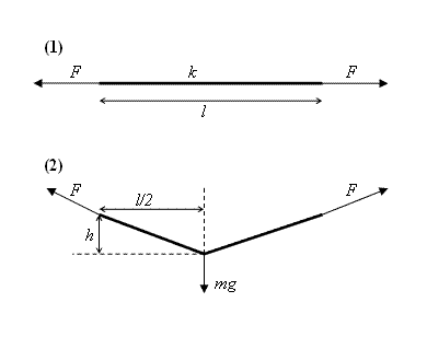

The problem:
See attachment for figure.
(1) A rope with a spring constant k is stretched by a force F.The length of the rope is l (including the deformation).
(2) A force mg is then applied at l/2 on the rope. This results in a height difference between the highest (and unchanged point) and the lowest point, h. The length between the endpoints where the force F is applied is still l.
Equations:
Hooke's law for springs: F=kx
Maybe something else? Cant see where and what though...
The question:
Set up an equation for the force F.
My attempts:
I've tried to solve this problem with geometric similarity between the force and the deformation, but obviously not correctly...

F in the figure 1 is not equal to F in the figure 2.
F in the figure 2 can be found in terms of mg by using vector method.
New half length of the string can be found in terms of l/2 and h.
Using these values you can find F in figure 1.

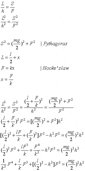

The F in figure 2 should be called S. If we call the new length of the rope (the hypotenuse) L, I get the following similarity: L/h = S/F
Then, with some algebra (see attachment), I get an equation I'm not sure what to do with.

L/h = S/F This is not correct. It should be L/(l/2) = S/F and h/L = mg/2S. Solve for F.
I'm not sure if I'm following you, but I tried what you suggested (attachment once again) and ended up with this:
F=(mgl)/(4h)
I have a bit problems believing that's correct as it would mean that an inelastic rope (k -> infinity) will stretch and bend down equally much as a elastic rope when the same force is applied.
