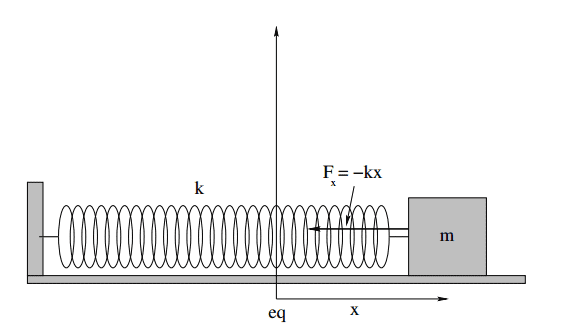

A mass ##m## on a frictionless table is connected to a spring with spring constant ##k## so that the force on it is ##F_x = -kx## where ##x## is the distance of the mass from its equilibrium position. It is then pulled so that the spring is stretched by a distance ##x## from its equilibrium position and at ##t = 0## is released.
Write Newton’s Second Law and solve for the acceleration. Solve for the acceleration and write the result as a second order, homogeneous differential equation of motion for this system.

I write the the Newton's Second Law and solve for the acceleration:
$$F = m a_x = - k x$$
$$a_x = -\frac{k}{m} x$$
Now it tells me to write the result as a second order, homogeneous differential equation of motion. I don't quite get how I should do this but I think this way:

Can you express ##a_x## as a second derivative?

Here you treated ##x## as a constant. But ##x## is a function of time. You are asked to find a second-order, homogeneous differential equation such that if you solved it, it would give you the answer for ##x(t)##. But the statement of the question does not ask you to solve the differential equation.

I can express ##a_x## as ##\frac{d^2 x}{d t^2}##.

A differential equation of motion for the mass would be a differential equation involving time derivatives of the unknown function ##x(t)##. No need to bring in ##v_x##.
Good, now substitute that into your equation $$a_x = -\frac{k}{m} x$$What do you get?

I would get $$\frac{d^2 x}{d t^2} = -\frac{k}{m} x$$
Kernul said:
So I should write ##\frac{d x}{d t}## instead of ##v_x##?
Yes, that's essentially it! You can put into "standard form" by arranging it in the form ##ax''(t) + bx'(t) + cx(t) = 0##. The zero on the right makes it homogenous.

No need to write the second equation. Rearrange the first equation to get 0 on the right and you're done.
So simply this?
$$x''(t) + \frac{k}{m}x(t) = 0$$
Yes. Writing the answer as ##x''(t) = -\frac{k}{m}x(t)## is probably OK, too. Writing it with 0 on the right just puts the differential equation in standard form. The question statement is not clear on whether or not you need to put it into standard form. Since it says, "solve for the acceleration" it could be that they actually want ##x''(t) = -\frac{k}{m}x(t)##. Who knows.
