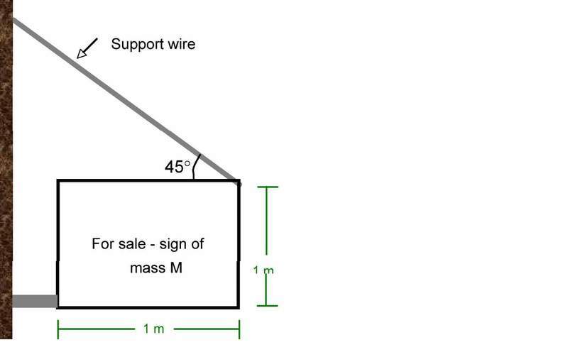

A businessman is hanging a sign outside his store in the
fashion shown in the figure below. The sign has a mass of
50 kg. For a sign of this mass, what is the tension in the
wire? The sign is rigidly attached to the wall at the lower
left corner.
A. 346 N
B. 260 N
C. 490 N
D. 87 N
E. 173 N
i am stuck. only thing i though of was find mg then find the sin of the angle
so i did mg sin (45)
490 sin (45) got 370.
which is not even close to letter E (which is the right answer)
  • Free-body style diagram of a rectangular sign labelled 'For sale - sign of mass M', 1 m wide and 1 m tall, hung from a wall by a diagonal support wire at 45 degrees to the top edge, with the lower left corner fixed to the wall.
If it's rigidly attached as it says in the question - then the tension in the wire is zero.
ie the sign would stay there without the wire
Normally in these question you assume the weight acts at the centre of the sign and take moments about the point that it joins the wall (assumed to pivot) to find the upward force at the outside end
The question is flawed.
Answer E is obtained if you assume the sign
can pivot freely about the bottom left corner.of the sign.
(hardly "attached rigidly"!)
Remembor the pivot can exert a force on the sign, but no torque.
David

so if we assume the sign can pivot, how would you go about getting answer E??
