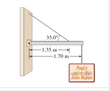

Anonymous123451234
A shop sign weighing 215 N hangs from the end of a uniform 155-N beam.
Tension in supporting wire= 642 N
Horizontal force exerted by the hinge= 526N
Find the vertical force exerted by the hinge on the beam at the wall
Fy= Fhy + Ft * sin() - mg - Mg =0
My attempt:
Fhy= -(Ft *sin() - mg - Mg)
=-(642*sin(35) - 155 - 215)
= 1.76 N
My answer is incorrect, but I don't know what I'm doing wrong.

How did you get that tension? I get rather less.

I used the formula Ft= (mg length/2 + Mglength) / (length*sin(35))
The cable is not attached to the end of the rod.
It doesn't matter where on the rod it's attached to in this scenario. It goofed me up at first because I thought it did matter when it actually did not. This is the correct tension.
For the torque, it matters.
However, you are right that the tension is 642N, I made a mistake.
So, now I wonder whether your 1.7 is not quite accurate enough. I get exactly 5/3N. (There's a lot of cancellation, and angle turns out not to matter.)
I get exactly 1.7639278626, rounded to 3 sig figs is 1.76 N which is incorrect.
To get the most accurate answer, forget the results for earlier parts of the problem. Using those introduces rounding errors.
Take moments about the point of attachment of the wire.
