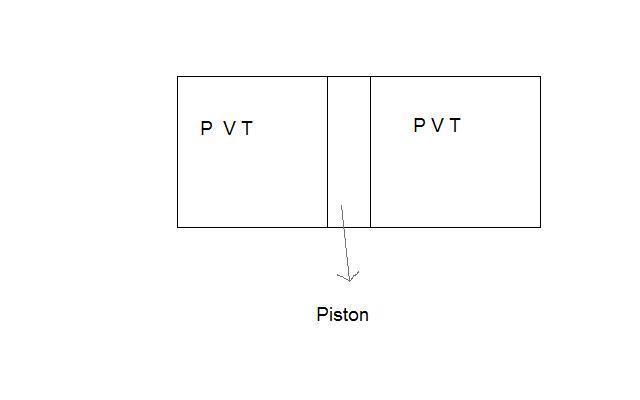

The figure shows the initial state of the gas in an insulated cylinder. The gas is ideal and it is given that, Cp/Cv = 1.5. The insulated piston by the help of an external agent is slowly shifted to the right such that the piston divides the cylinder in the ratio 1 : 3. Calculate the work done by the external agent.
I calculated the final temperatures
T1 = √2/√3 T and T2 = √2T
Increase in internal energy of the entire system of gas ,
U = (n1+n2)Cv(T1 + T2 -2T)
Cv = 2R
U = 2RT(n1 + n2)(√2/√3 + √2 - 2)
(n1 + n2)RT=2PV
therefore U=4PV(√2/√3 + √2 - 2)
The answer is U=2.5PV(√2/√3 + √2 - 2)
Please help

You will have to explain how you are getting the temperatures. Show all your work, including how you get W from [itex]\Delta U[/itex]
AM
Sure. I skipped that to save time.
Let V1 and V2 be the final volumes of the left and right parts resp.
V1=3V2 and V1 + V2 = 2Vo
Hence V1 = 3Vo/2 and V2 = Vo/2
As the process is adiabatic,
For the left part, TV[tex]\gamma[/tex]-1 is constant
Using this equation, T1 = √2/√3 T
Similarly applying the same equation for the right part,
T2 = √2T.
Work will be done by the gas at the expense of its own internal energy ( there is no heat exchange )
W = -[itex]\Delta[/itex]U
But work is done on the system hence it is -W
W = [itex]\Delta[/itex]U

I already got the concept behind the question.
My problem is that my answer doesnot match with the given answer.
I calculated n1 + n2 as follows-
the number of moles present in the final condition in both the parts are equal to the no. of moles present in each part initially.
so n1 = n2 = PV/RT
n1 + n2 = 2PV/RT
Substituting this in the equation,
U = 2RT(n1 + n2)(√2/√3 + √2 - 2),
U= 2RT x 2PV/RT (√2/√3 + √2 - 2) = 4PV(√2/√3 + √2 - 2).
Is there any mistake in calculation of number of moles?

The above part of your analysis is not correct:
[tex]W = \Delta U = n_1C_v\Delta T_1 + n_2C_v\Delta T_2 = n_1C_v(T_1 -T) + n_2C_v(T_2 - T) \ne (n_1 + n_2)C_v(T_1 + T_2 - 2T)[/tex]
If n1 = n2, you will be out by a factor of 2. Are they equal?

You should use:
[tex]\Delta U = nC_v\Delta T[/tex]
You should get:
[tex]W = \Delta U = nC_v\left(\frac{\sqrt{2}}{\sqrt{3}} + \sqrt{2} - 2\right) T[/tex]
where n is the number of moles in one side of the cylinder. Determine what [itex]C_v[/itex] is in terms of R and [itex]\gamma[/itex] and use that value. AM

I proceed as you told -
n = PV/RT
Cv = R/[tex]\gamma[/tex]-1 = R/1.5-1 = 2R
W = nCv T(√2/√3 + √2 - 2) = PV/RT x 2R x T(√2/√3 + √2 - 2) =2PV (√2/√3 + √2 - 2)
The answer given in my book is W = 2.5PV (√2/√3 + √2 - 2)

I get the same as you. So I would say that the book answer is wrong.
The answer in terms of gamma is:
[tex]W = nC_v(\Delta T_1 + \Delta T_2) = n(\frac{R}{\gamma-1})T(\frac{\sqrt{2}}{\sqrt{3}} + \sqrt{2} -2) = \frac{nR}{\gamma-1}(\frac{PV}{nR})\left(\frac{\sqrt{2}}{\sqrt{3}} + \sqrt{2} -2\right)= \frac{PV}{\gamma-1}\left(\frac{\sqrt{2}}{\sqrt{3}} + \sqrt{2} -2\right)[/tex]
