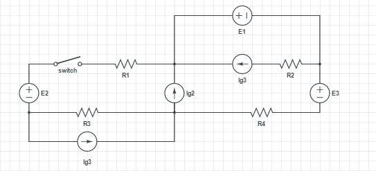

In the circuit above ##E_1=E_2=E_3##, ##Ig_1=Ig_2=Ig_3## and ##R_1=R_2=R_3=R_4##. In the case when the switched is closed the power of the ideal generator ##E_2## equals ##P_{E_2}=-30W##. Then the switch opens. Calculate the ##ΔP_{E_1}##.
3. The Attempt at a Solution [/B]
First i express the power of the generator 2 as the product of its voltage and the current it produces. So:
##P_{E_2}=E_2*I_2## (some ##I_2## that's flowing out of the generator). Then to calculate the power of the first generator i need to see how this current that the second generates distorts the first. I take the Kirchhoff's first rule of current flow to the node which connect the ##Ig_2## an ##R_1##
##-I_2-I_1-Ig_1-Ig_2=0##
From there ##I_1=-Ig_2-Ig_1-I_2##
When the switch is closed i get ##I_1'=-Ig_2-Ig_1##. This is the point where I am stuck. The difference is in the ##I_2## factor. So the difference in the energy is just ##E_1*I_2##? That would be the same as the given energy so my difference would be ##-30W##, but i get ##30W## as the result in the book. Where am i wrong?

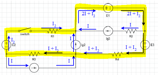

While the switch is closed the power associated with E2 is -30 W. By the usual convention of component power that means it's injecting 30 W into the circuit. When the switch opens it no longer injects that power, and the loss would be felt by E1 as a drop in the amount of power it consumes. That would translate into a negative ΔP for E1.
However, the problem I'm having is justifying having E2 supply power rather than consume it. For the given circuit I think it has to consume power, the direction of ##I_2## being opposite to what I've drawn in the above circuit. I'll need to study the circuit a bit more to see if it's possible for E2 to drive current in the way I've indicated.
Update: No, I don't think it's possible for E2 to supply power. ##I_2## should enter the + terminal of E2, and so E2 must be consuming power.
If all the current sources have the same value ##I##, and all the voltage sources the same value ##E##, and all the resistances have the same value ##R##, all of them positive constants, then using KVL around the only current-source-free loop you should be able to show that the ##I_2## as drawn in my diagram must be negative.
This would mean that the book's premise that ##P_{E_2}## is negative would be false unless they're using a different convention for the power for voltage sources.

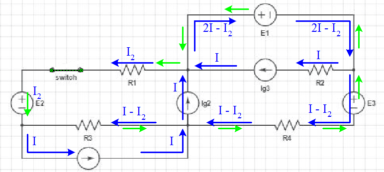

What I was pointing out is that the actual current flowing through E2 when the switch is closed must enter at E2's + terminal. For the power associated with E2 to be negative, the book must use the convention that negative power is equivalent to energy consumption for sources.
Now, this ##I_2## that flows through E2 also flows through E1, but in the opposite sense. Here's the circuit diagram again with the currents indicated and their "true" directions used. The blue arrows and labels represent the net currents, while the green arrows represent the ##I_2## contribution to the total current in any given path.
Notice how ##I_2## flows out of E1. It represent a positive power component for E1 (by the book's apparent convention for source power). Opening the switch would "turn off" the green components, so that would be a negative ΔP for E1.
So in my opinion the book has the wrong sign on its answer; The ΔP for E1 should be negative when the switch opens.

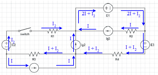

Source E1 changes from supplying power to absorbing power, so this is a change that is negative.
∆PE1 of –30W looks right, so possibly the book was interested in merely the magnitude of that change.[/color]
