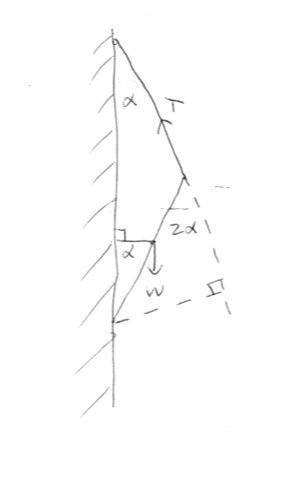

quietrain
648
if i take moments at point O, does it mean that
LTcos(a) = (L/2) mg
and hence T = 32?
but answer is 16.
what am i missing out here? thanks!
You might want to try this in the Homework section. They should be able to help you there!
Get the geometry right and it comes out at 16.171.
Does this sketch help?
oh shucks... i forgot to put in homework ... they are going to infract me again :(
anyway, i think i know why i got it wrong, the wall has a normal force that balance the x component of the tension
but i have a question, where is the normal force of the wall? at P or O? but since i take moments at O, will that come into play?
erm i assume you resolve the weight to match the tension?
i was trying to solve by resolving in x and y components
No I didn't resolve anything.
Your original idea of moments about O was good - you just fell down in the implementation.
I hoped my sketch would help since it was the geometry you got wrong, but I wanted to leave something for you to do.
Remember the moment is the perpendicular distance from O to the line of action. This is why I drew in some perpendiculars.

er, sry, ignore the sketching on the original diagram, those aren't mine :(
but anyway, i know where i went wrong already
LT = L/2 mg
in component form
summation of torques at O ,
x comp + y comp = weight comp
Tsin(alpha)* Lcos(alpha) + Tcos(alpha)* Lsin(alpha) = (L/2)mg sin(alpha)
T=16.171my mistake : i forgot that the summation of moments is the whole tension and not only the y-component of the tension. did you meant that? and thank you for drawing, i appreciate it
ok thanks everyone!
Just for the record, my amended version of your original equation leads to
Lsin(2a)T = 1/2mgLsin(a)
T = 1/2mg sin(a) / sin(2a)
using my sketch and not resolving into components.
go well
