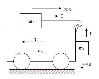

All surfaces are smooth. mass m1 is attached to m3 with a smooth rail, it can't detach.
What are the accelerations of the masses relative to the floor.
Conservation of momentum: ##m_1v_1+m_2v_2=0##
a3 and a2are the acceleration of masses m3 and m2 relative to the floor. ##a_2'## is m2's acceleration relative to m3.
In the accelerating frame of m3:
$$\left\{ \begin{array} {l} m_2a_3+T=m_2a'_2 \\ m_1g-T=m_1a'_2 \end{array} \right.$$
Accelerations relative to the floor: ##a_2=-a_3+a'_2##
These equations yield a relation between a3 and a2 that includes g.
If i consider relative to the floor, from conservation of momentum:
$$(m_1+m_3)v_3+m_2v_2=0\Rightarrow (m_1+m_3)a_3+m_2a_2=0$$
From this we get relation without g.

I don't think that it matters that the masses accelerate, there is still conservation of momentum since there aren't any external forces in the x direction, so the whole of the masses can't move. the C.O.M remains in place, and from that i also got the same answer.
The only force i see that acts on m3 is the tension T. relative to the floor:
$$\left\{ \begin{array}{l} m_1g-T=m_1a_2 \\ T=m_2a_2 \end{array}\right.\Rightarrow a_2=\frac{m_1}{m_1+m_2}g$$
The tension T acts on m2 and on m3:
$$F=ma\rightarrow m_2a_2=(m_1+m_3)a_3$$
This is the same as momentum conservation, same as before.

No masses are given for the wheels, so we should take them as massless. The consequence is that it will be just as though m3 is sliding on the ground without friction.
As Karol posted, there are no external horizontal forces on the m1+m2+m3 system, so its mass centre stays put, and conservation of momentum can be used. However, the trap is that m3 will lose contact with m1.
Karol, I'm not sure what question you are asking with your post. You ended up with two equations and two unknowns, which is fine if the equations are correct. What stopped you at that point?

The string exerts a normal force around the curve of the pulley. The net of this will be a force acting down and left at 45 degrees.

I am very sorry i didn't draw it more clearly and didn't explain the conditions.
Mass m1 can't detach from m3 because it slides on a rail that is attached to m3!
No, my mistake - you did indeed write that in the OP.
So, what's your issue?
The issue is that when i solve in the non inertial frame attached to m3:
Accelerations relative to the floor: ##a_2=-a_3+a'_2\rightarrow a'_2=a_2+a_3##
With conservation of momentum: ##(m_1+m_3)a_3+m_2a_2=0## i get:
$$a_3=-\frac{m_1m_2g}{(m_1+m_2)(m_1+m_3)-m_1m_2}$$
Relative to the floor:
$$a_3=-\frac{m_1m_2g}{(m_1+m_2)(m_1+m_3)}$$
The denominator is different
$$ m_1g-T=m_1a_2 $$
That does not look right to me.
$$\left\{ \begin{array}{l} m_1g-T=m_1a'_2 \\ T=m_2a_2 \\ a_2=a_3+a'_2 \end{array}\right.\Rightarrow a_2=\frac{m_1g-m_1a_3}{m_1+m_2}g$$
$$(m_1+m_3)a_3+m_2a_2=0$$
$$\Rightarrow a_3=-\frac{m_1m_2g}{(m_1+m_2)(m_1+m_3)-m_1m_2}$$

All good now?
Thank you very much Haruspex and the others
