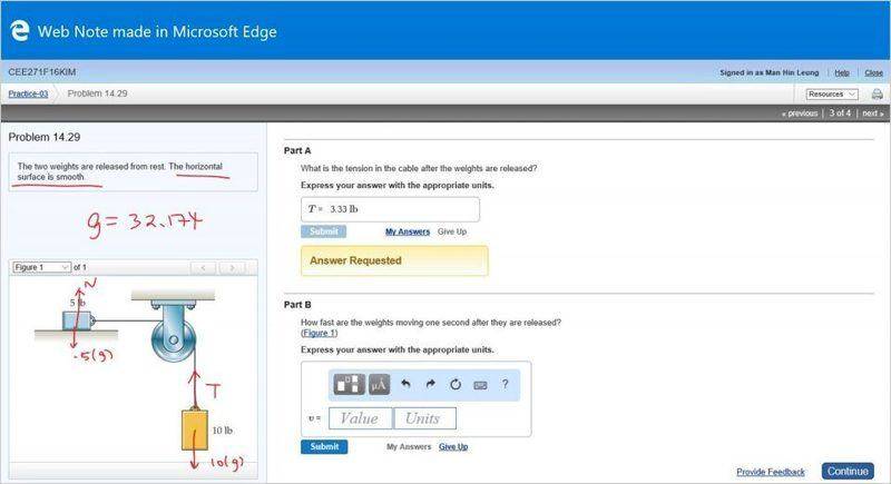

Sum of Force
g = 32.174 ft/ s^2
I consider the right hand side weight,
T = -mg = - 10*32.174 = 321.74 lb
Why is the answer 3.33, which seems to be even smaller than the mass??
Should I consider the momentum, or something with the 5 lb mass??
Thanks.
The tension is equal to the weight only if the velocity of the mass is constant. Here there is acceleration and you need to take that into account.
Also check your units. Is 10 lb x 32.174 ft/s2 really equal to 32.174 lb?

First the units. When you see a number with lb. next to it, that means weight which is a force. To find the mass (the unit is slugs) you divide the weight in lb. by 32.174 ft/s2. The number you get should be used wherever "m" appears. If g appears next to m, as in mg, you just use the number for weight in lb.
Now for the acceleration. Newton's Second law says that the um of all the forces is equal to mass times acceleration.
1. What is the sum of all the forces acting on the mass on the table?
2. What is the sum of all the forces on the hanging mass?
Once you have the answer to these two questions, you can set each equal to the appropriate mass times the acceleration.

1. x direction: Tension y direction: Normal force, and Weight
2. x direction: none y direction: Tension and weight
So I set F_x1 = F_x2?
and same for y dir?
Consider the mass on the table first. There is only one force in the x-direction which means that the net force in the x-direction is just T. So, according to Newton's Second law, in the horizontal direction
1. T = ??
In the vertical direction, the mass just slides on the table without jumping off it or sinking into it. What does that make the vertical acceleration equal to?
2. avertical= ??
Now for the hanging mass. Nothing is going on in the horizontal direction. What is the net force in the vertical direction?
3. Fnet,y= ??
Finally, set the net force in each direction equal to the (appropriate) mass times acceleration in the same direction. You also need to consider whether the two masses have the same acceleration and why or why not.
