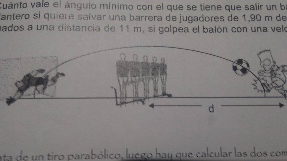

How much is the minimum angle at wich a football thrown by a striker has to come out if he wants to save a 1,9 m player barrier that are located at a distance of 11 m, if you hit the ball with a initial speed of 100 km/h?
##v_x=v_0\cos{\theta}=d/t##
##v_y=v_0\sin{\theta}-gt##
I can't solve ##\sin{\theta}\cos{\theta}=0,14##
Thanks!

Here is the image of the parabolic movement. Excuse my spanglish ("parabolic movement" is the words for this image?)
Ooops... Hope not to done something not allowed

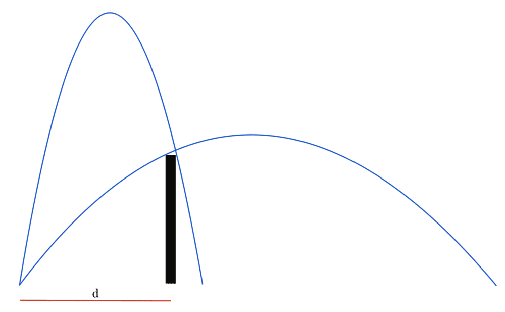

Like @haruspex mentioned, you can't assume that the ball crosses the barrier at the highest point of its trajectory. You are expecting solutions that look something like this:
Generally you will have 2 distinct solutions for ##\theta##, corresponding to each trajectory. Only if these both happen to be the same will highest point on the trajectory be at the barrier.
  • Wow
Likes Delta2, Lnewqban and mcastillo356
