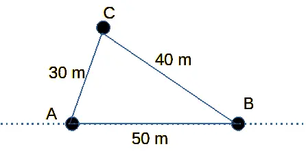

There are 3 particles a, b and c. A moves towards B with velocity 5 m/s and B moves towards A with same speed as A. C moves such that separation between B and C is always 40 and separation between A and C is always 30. initial distance between A and B was 50m. Find velocity of C as a function of time.
dr/dt = v
I tried to solve using trigonometry.
Let angle between line CA ad BA be theta and angle between BA and AC be alpha.
30sin theta= 40 sin alpha
30 cos theta + 40 cos alpha + 2vt=50
I have no idea how to proceed after this.

I would approach it using Cartesian coordinates. What would a convenient X axis and origin be, using a certain symmetry in the question?

Setting up this problem becomes easier if one recognizes that the starting configuration is a 3-4-5 right triangle.

At t = 0, the configuration is this (not to scale):
Consider the positions some time later. A and B are closer (A and B are heading towards each other with speed-of-approach = 10 m/s) and the configuration is, for example, this:

Not sure about that. In post #1 it says:
anthraxiom said:
... A moves towards B with velocity 5 m/s and B moves towards A with same speed as A. ...
I interpret that as A and B moving towards each other along the same straight line. It would then be implicit that the question is asking for v(t) during the first four seconds (so we needn't consider the infeasible case where |AB| is less the 10 m).

Indeed. The equations will lead to the y coordinate (distance from C to the line AB) becoming imaginary.
