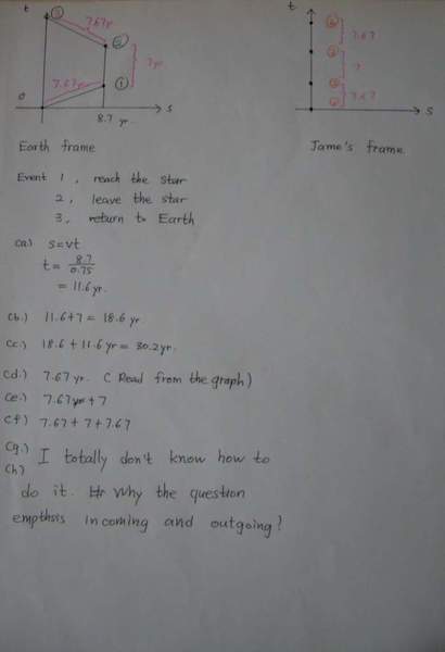

athrun200
275
I am sorry, I don't understand what is the relationship between twin paradox and my question.
Incoming and outgoing just tells you what direction the stations are moving. It just means that they're at rest relative to James.
