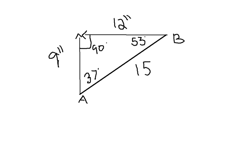

Trig
Something around the lines of this?
ForceY=force(a-b)*sin(some angle) -orce(b-c)sin(some angle)+force(c-d)sin(some angle)
Did what I did using paint. I think I am suppose to be doing something like this. Now I don't know where to go from here.
